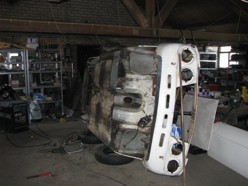

Here is a picture although you can't see the wind shields are still in. It is difficult to go inside the car.
on the side.jpg (107.61 KiB) Viewed 951 times

great, many thanks! If I understood you clear, you'll need in total 6 tires: 2 (as in the picture) to support the body and 2+2 (on top of eachother) to support the roof. Right?
Huib
Site Admin
Posts: 1886
Joined: 17 Dec 2008, 10:12
Re: Rolling a Fulvia Coupe on its side without removing windshields
Unread post by Huib »
4 tyres in total. Under the edge of the roof is just a single pile of two tyres.

add many pillows, blankets, foam rubber.....please :)
