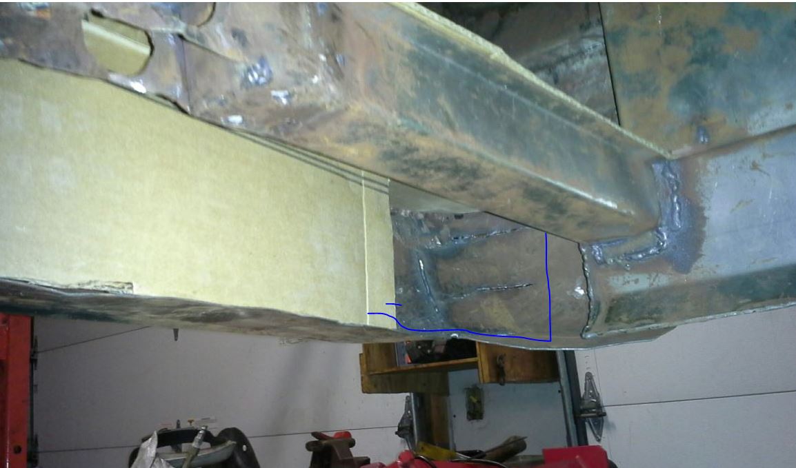

I can see how this welded support (cardboard template in picture) attaches to the wheel well in the sent pictures but not sure how it attaches to the rear of the car (shown in blue)

Ciao Brian, referring to the attached the "empty space" between the two walls continue, turning in the corner, up to the wheel mudguard.

got it thanks

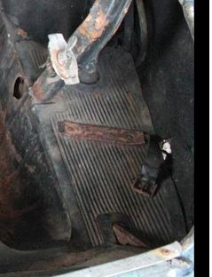

The parts catalog shows a tool strap assembly attached to a baseplate and the reference pictures of a trunk show a strap assembly fastened to the trunk floor. What is the correct assembly configuration for the tool mount and does anyone have detailed information of this assembly to replicate the components (strap, strap bracket, and fastener size and location)?
grifo63
Posts: 705
Joined: 07 Aug 2010, 21:26
Re: Flavia trunk repair
Unread post by grifo63 »
Hi bmw8890, I've this assembly on my Flavia berlina (sedan) but in the convertibile it is missing and neither the fixing holes are present; Moreover the spare part catalogue references are for 815.00 only.
However I appreciate it is useful tool, if you wish to add to your convertibile I'll post some details in the next days.

grifo63
Posts: 705
hereafter some details:
4 is a soft rubber dumper plate
7 is a black painted thick natural leather belt approx 500mm lenght 30 mm wide
22 is a U iron profile 160mm lengh, 33mm wide hold by 2x M5 screws; the spare wheel colums nearest screw is 115mm far from it and all assembly is about 20° rotaded vs car main axle (see the picture).
cintura attrezzi flavia.jpg (197.33 KiB) Viewed 1037 times
