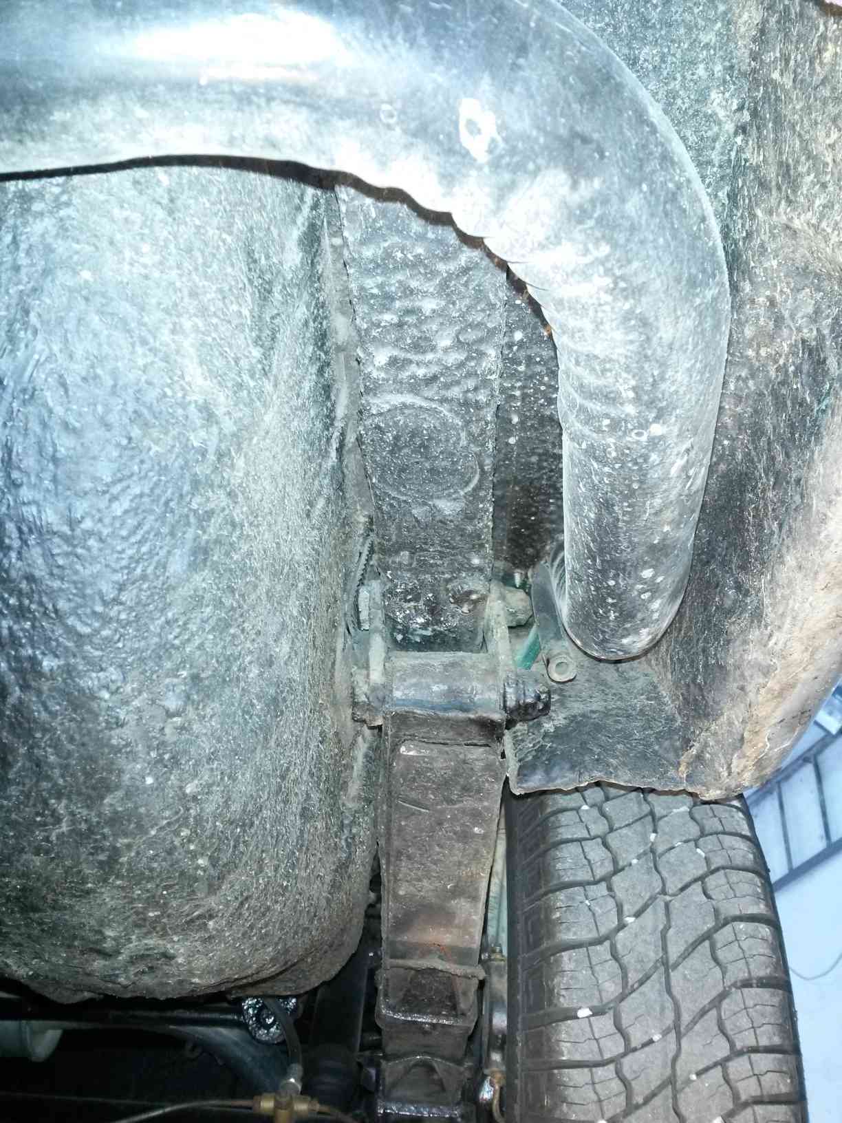

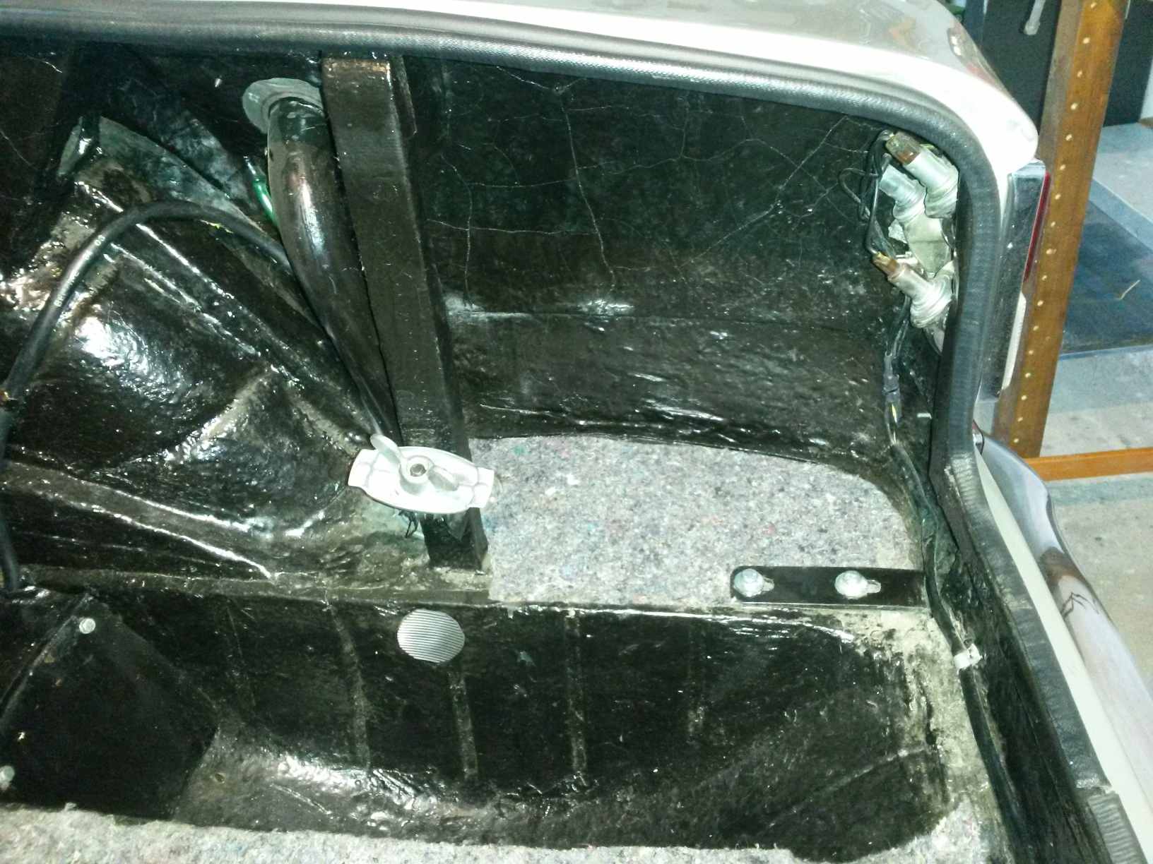

Hi,
please find attached a couple of picture of trunk right side zone of my car, with an upper upper and bottom view.
I hope can help you, if you need to magnify some details please mark it in the picture and I'll try to do a better shot.

Re: Flavia trunk repair
Unread post by grifo63 »
.. just another picture

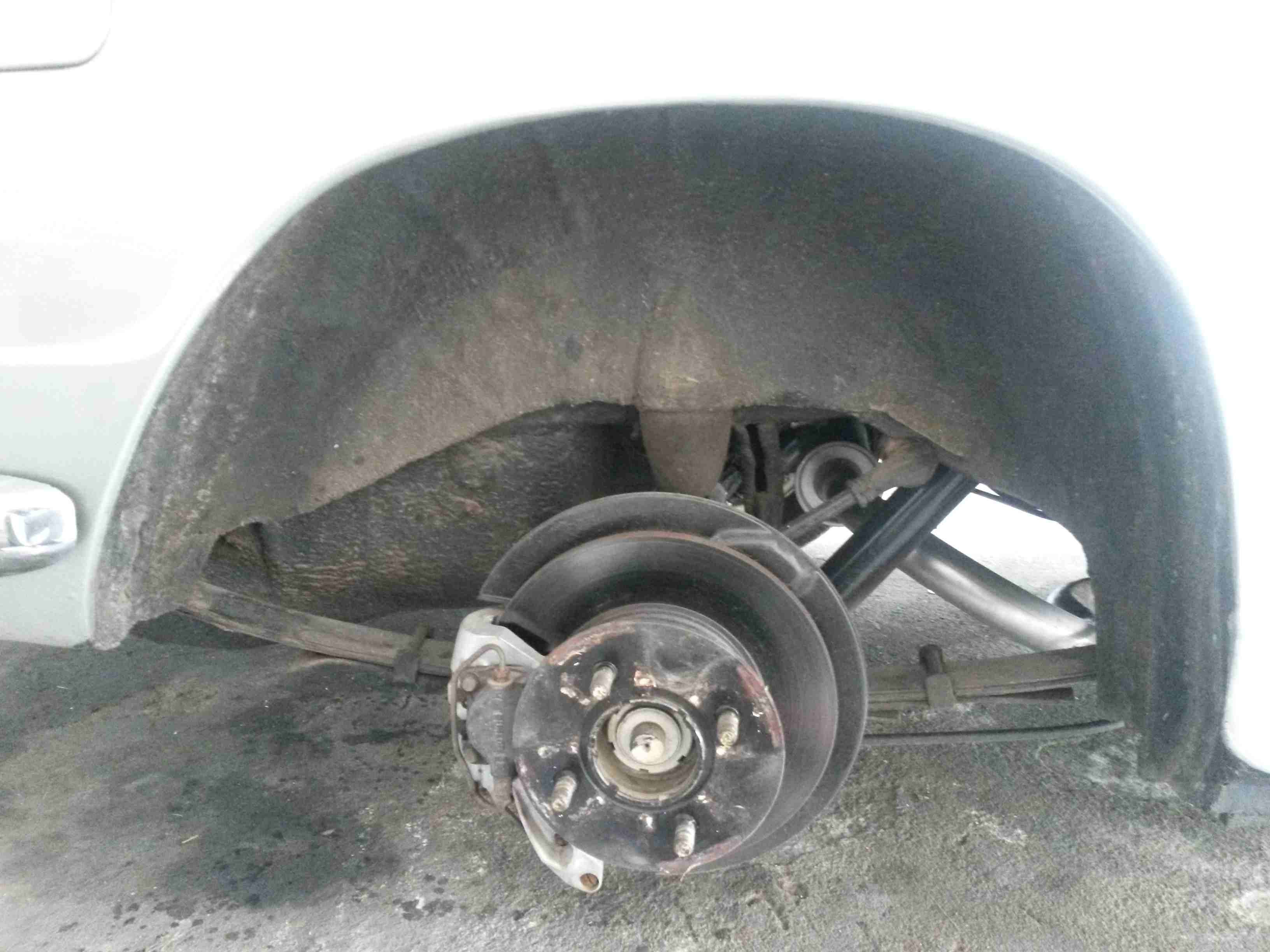

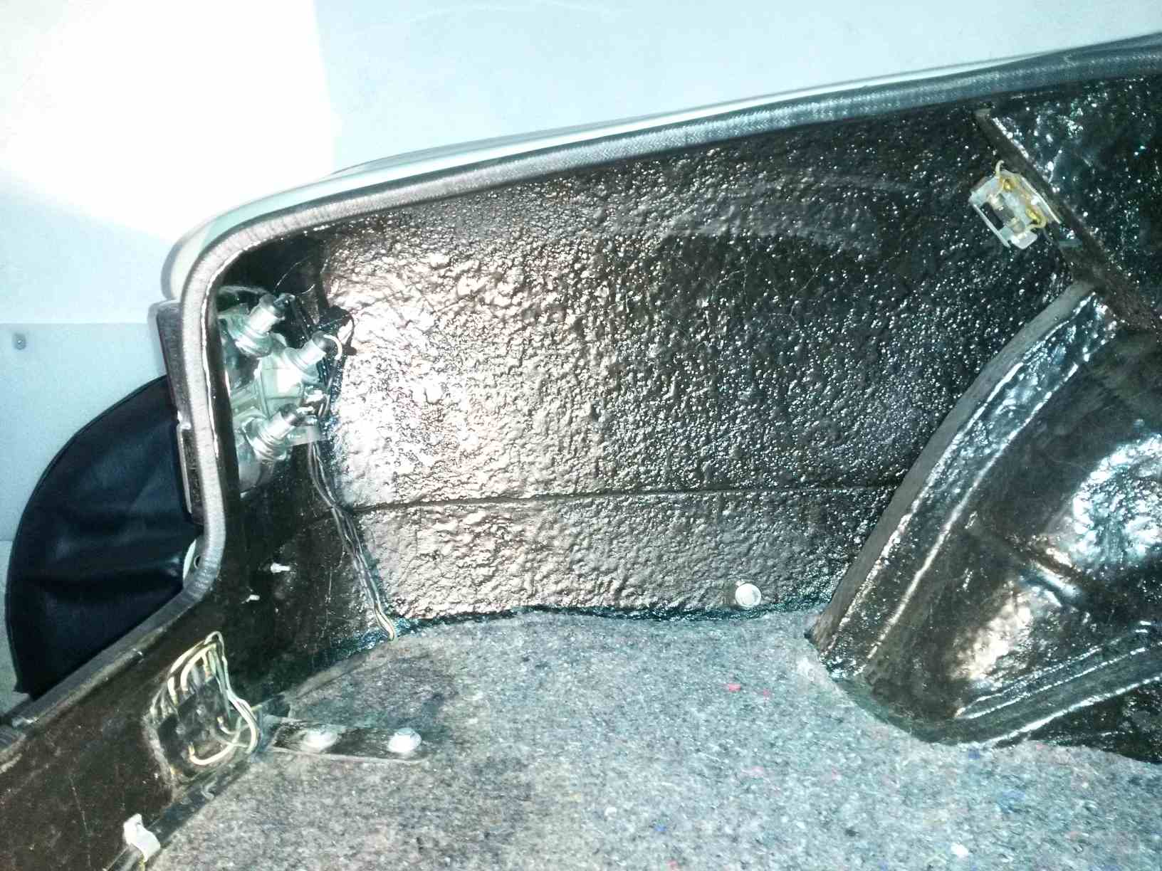

Can you send a pictures of the other side of both inside and underside? Thanks for the pictures that you sent.
grifo63
Posts: 705
Joined: 07 Aug 2010, 21:26
left side, here they are....ciao.

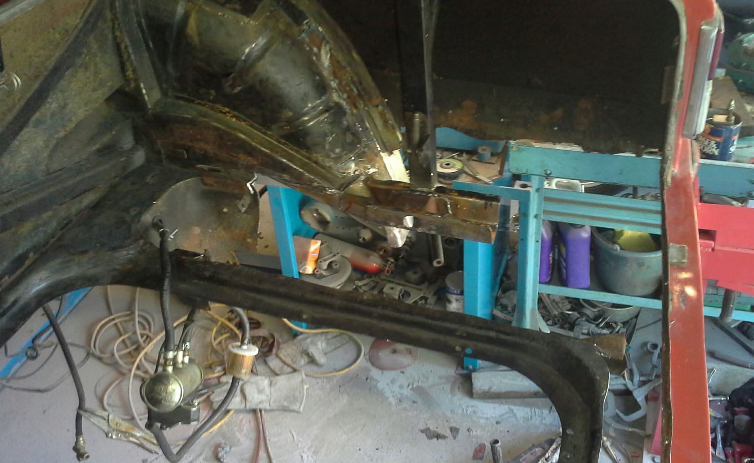

looking for a picture under the trunk of the wall that attaches to the fender as shown in the attached file. Not sure how it attaches to the back section of the trunk rear support.
Thanks,
brian

Ciao Brian, the fender is attached in the support upper side by the brackets and bolts visible in the pictures I've alredy posted here; from the bottom you can't see anythings.
