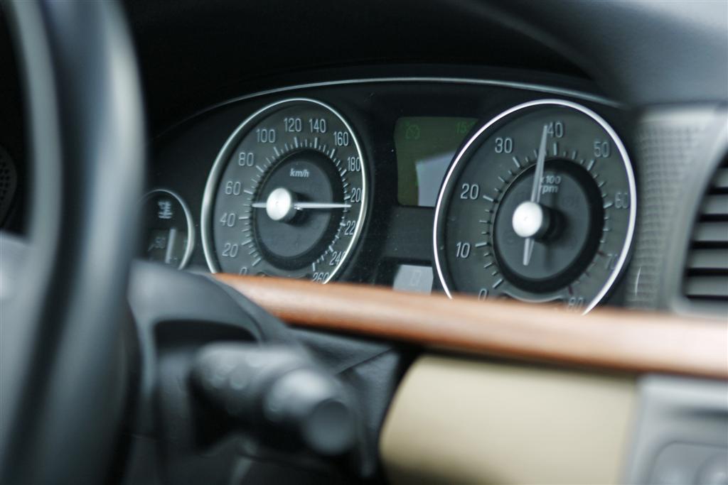

- dsc09103 (large).jpg (63.52 KiB) Viewed 366 times
