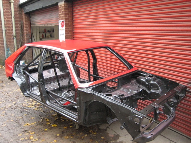

pic one shows the shell after preparation and a zinc dip to high standards,note this chassis has a genuine abarth plate kit and cage gravel spec inc pressed turret tops,sills,engine bay legs plated,seam welded,all major joints have extensive structural reinforcement

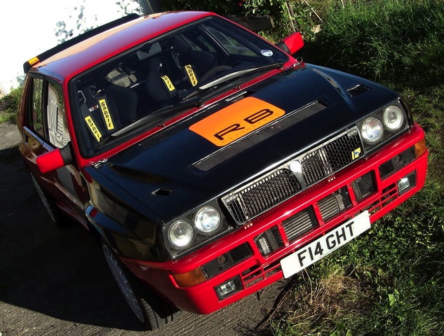

pic 2 car at a shakedown
quick spec
ex wrc carbon seats,sabelt 6 point harness,stack dash display,52mm stack egt lamda,boost,temp,bbm engine oversize headbolts,uprated internals and flowed head,turbo technics 360 turbo,one off tubular manifold,double spring coilovers with helpers,group a top mounts,forest spec 4 pot brake kit,glass removed perspex fitted,carbon wrc handbrake,bias adjust,a&h alloy big core rad,alloy oil cooler and oversize intercooler,ah fuel cell,atl gauge and filler,carbon boot,bonnet,front wings + more

abarth rear turret plate and cage after zinc dip

painted and prepped by john brain then moved to tanc barratt

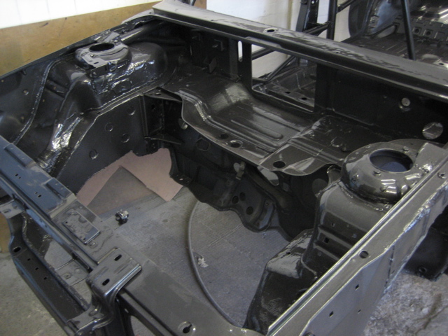

engine bay,note the chassis leg plate and turret top.roll cage attaches to the turret tops

goodwood festival of speed 2010 richard burns foundation display
attracted a lot of attention as a "work in progress"
