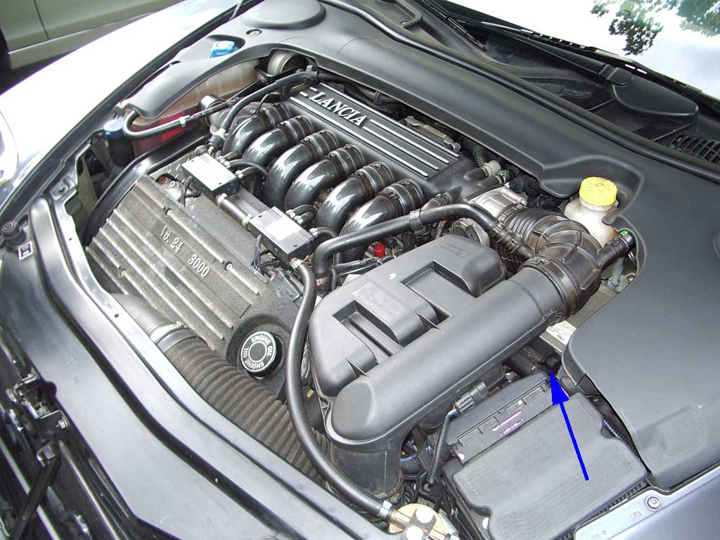

For the 4 problem, clear this connection
- abs_unit.jpg (105.79 KiB) Viewed 896 times
Re: THESIS V6 3.0 2003 : Strange Electronic troubles.
I guess you meant to clean the contacts of the connection.....
Gruss.....Starbiker
Hi Pierre!
You must take the conector off (giorgios picture) and just use the contact spray. If that dosnt work you must get the software and just reset all the inputs in the main computer. That is work for a mechanik.
