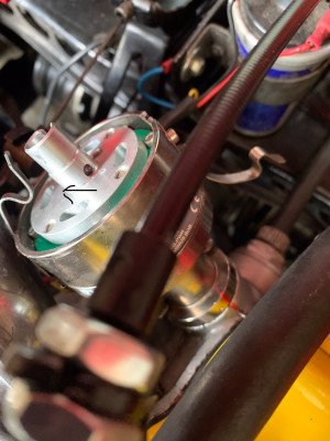

Hi my programmable 123 won’t connect to my laptop I suspect a dry joint on the usb socket my question is in order to fix this I need to remove the tapered drift pin shown in the picture but which way does it come out I’m thinking it’s the direction indicated with the arrow

slyg wrote: 29 Jan 2026, 20:21 Hi Jimbo1, did you manage to sort out your distributer issue in the end ? I've been eying off the 123, but wonder if the USB or BT is over the top of general use. Any advice or comments from your experience ? Cheers, Brad
Yes it was a problem with the pcb I contacted 123 ignition and they sent a new board it was easer than sending mine back (thank brexit for that ) put it all together now all works perfectly, if you have an engine that is tuned I would recommend it also bear in mind no points or condenser to fail,and she starts every time in the cold, and wet weather
