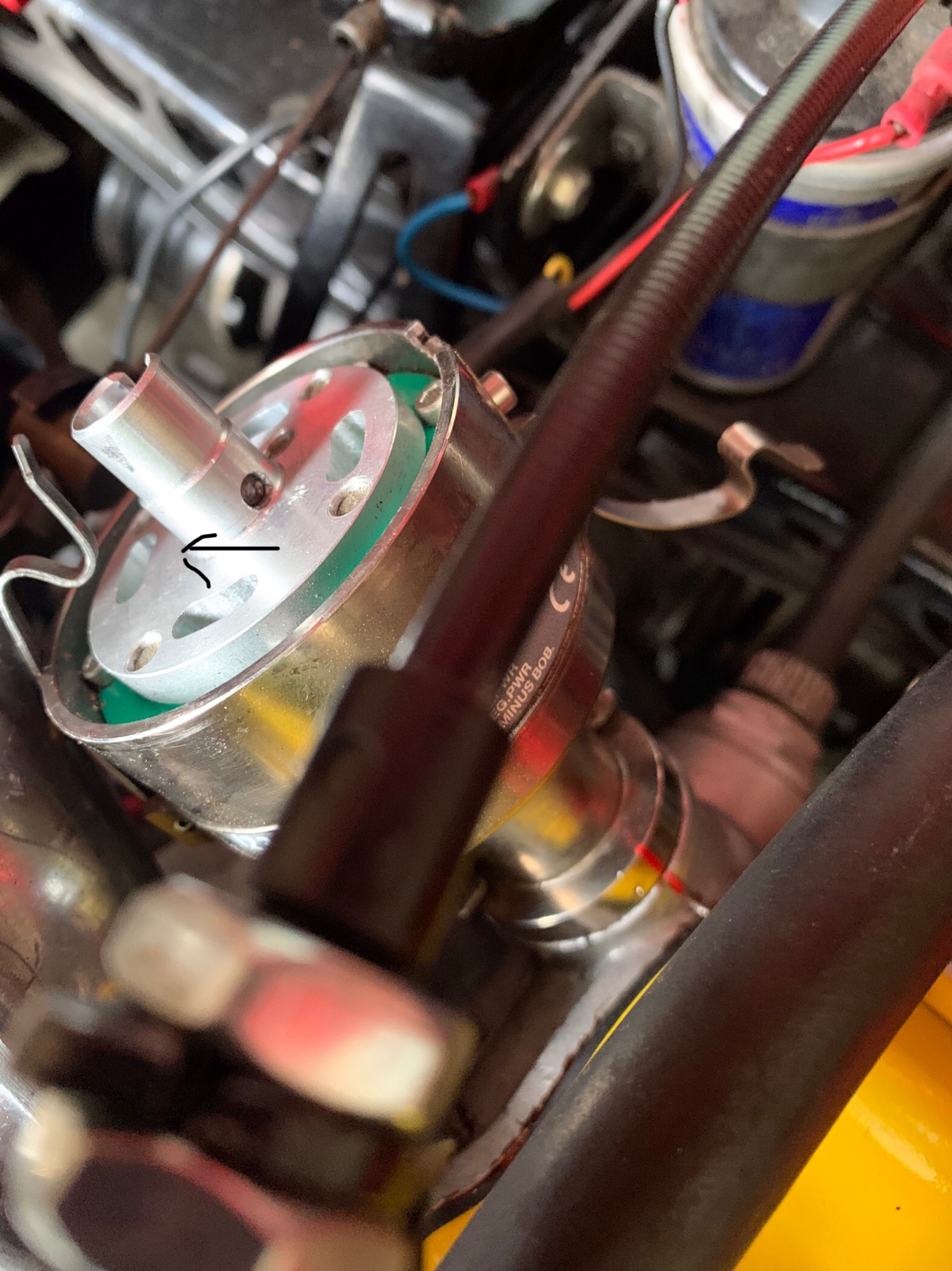

Hi my programmable 123 won’t connect to my laptop I suspect a dry joint on the usb socket my question is in order to fix this I need to remove the tapered drift pin shown in the picture but which way does it come out I’m thinking it’s the direction indicated with the arrow

Hi Jimbo1, did you manage to sort out your distributer issue in the end ? I've been eying off the 123, but wonder if the USB or BT is over the top of general use. Any advice or comments from your experience ? Cheers, Brad

Re: 123 distributor
