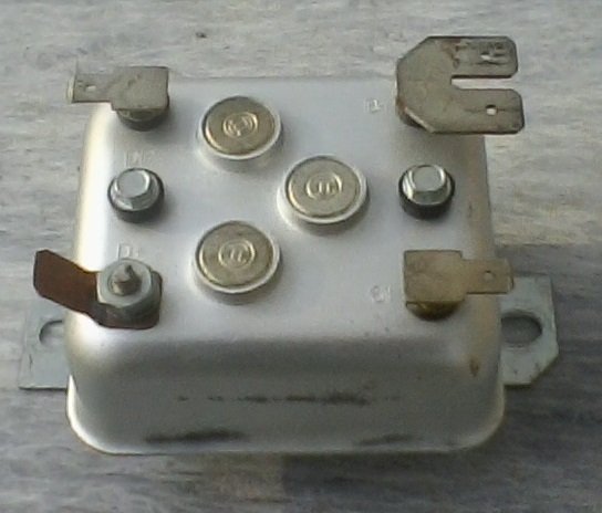

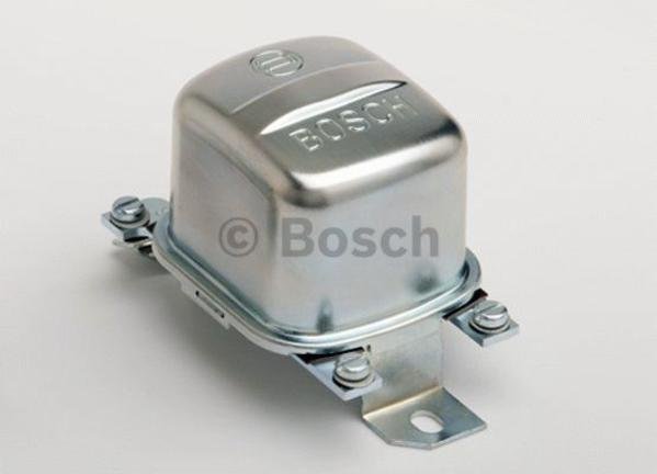

There are actually TWO electronic VR versions that you can use (for dynamo). One is the version that Huib talked about. It has the advantage being cheaper, but has a different form factor than the original, and has the potential problem of the having the (unfused) main voltage on the outer case. There is a version that is almost the same as the original, the only difference it is with screw connections instead of the normal "spade" connectors. That one is significantly more expensive however. I have installed the latter, with spade connectors screwed on so that it looks practically original (took me a bit of work to find all correct spade connectors for screw on, especially the large ones).

OK, I have been doing some research. The version with the different form factor (the one Huib talks about) apparently has become quite more expensive. and is now practically as expensive as the one that has the same form factor as the original VR. The number you gave is the one with the same form factor alright (but uses screw connectors rather than spade connectors). below some pictures.
The electronic VR is a lot better than the original. Not only is it solid state (so no moving parts and no wear in the traditional sense) but it also contains additional protection circuitry to protect both the generator and the battery.
Trying to include pictures of both versions below. One pic is the one with the original form factor with spade connector adapters as installed in my S1 Coupe.

Just to be sure. The one I talk about is the one with the spade connections and the diodes visible in the top of the case.

Remember that the housing carries the output voltage of the dynamo. Around 14,5 - 15.0 volt dc if the diodes are Schottky diodes. I bet they are.
My guess is that the three diodes are in parallel to each other and in series with the dynamo. The full curren will then go through the diodes. They get hot and need a heatsink. The housing functions as heatsink. Although the circuit dissipates heath it is also simple, fool proof and effective.
