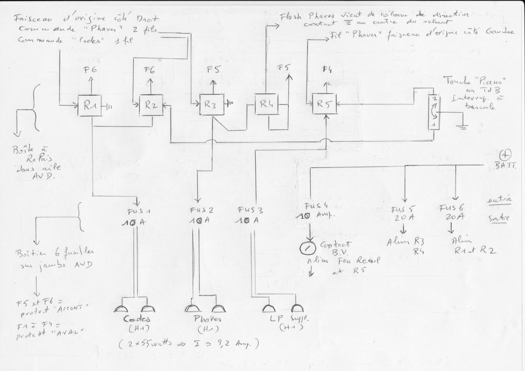

I place a picture showing the wiring I have made on my car : the contacts and the relay inside the fuse box are still in place. (I have to say my car is fitted with 4 H1 lamps) (text hand made and in french, sorry)
My purpose was triple :
- insert relays for feeding the main and low beams
- have the 4 lights "on" when main beams are "on"
- with the third switch on the dashboard, operate the "supplementary road lights" instead of the "low beams"
The result is correct, even if the strenght for lighting the road is not much increased....(my glasses are yellow, and I like this !)
