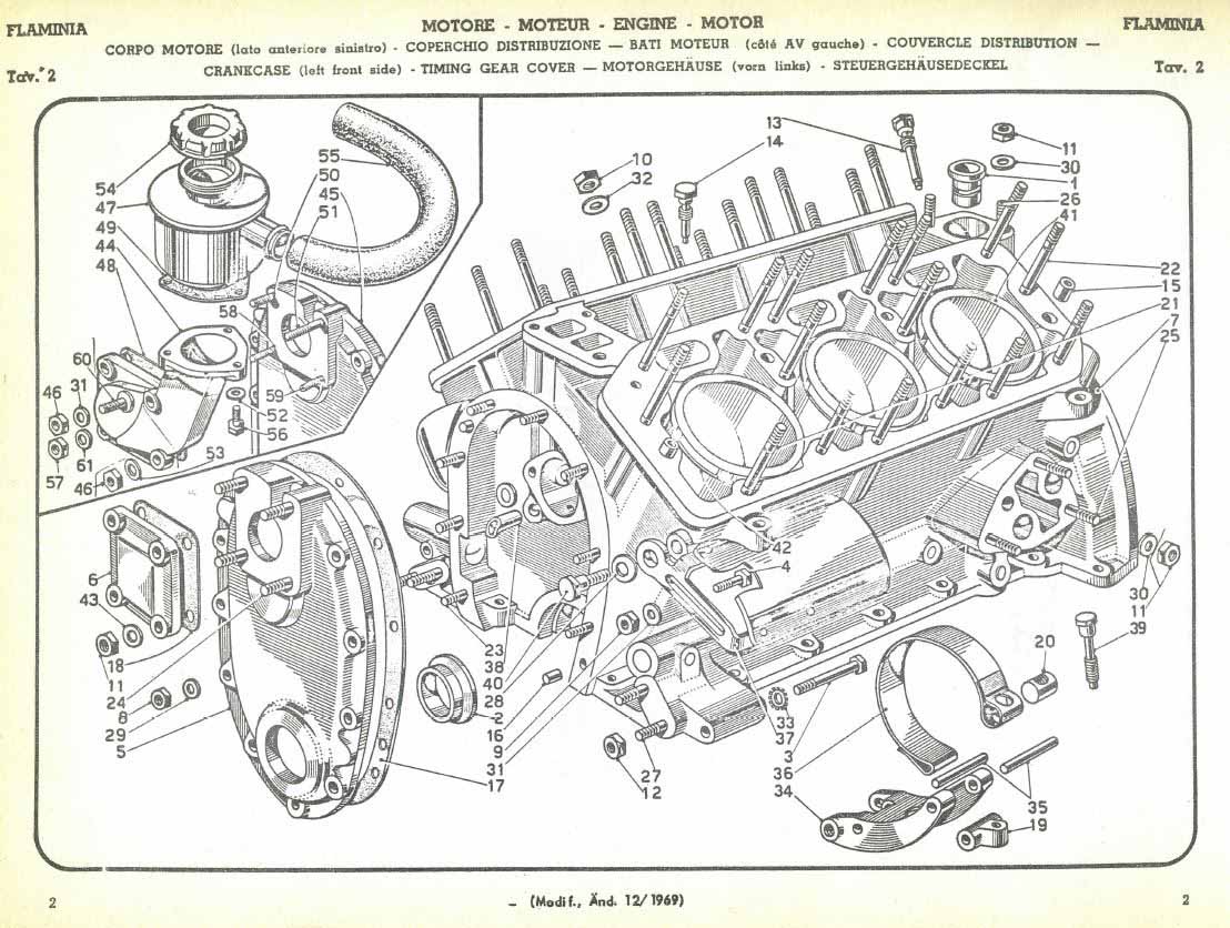

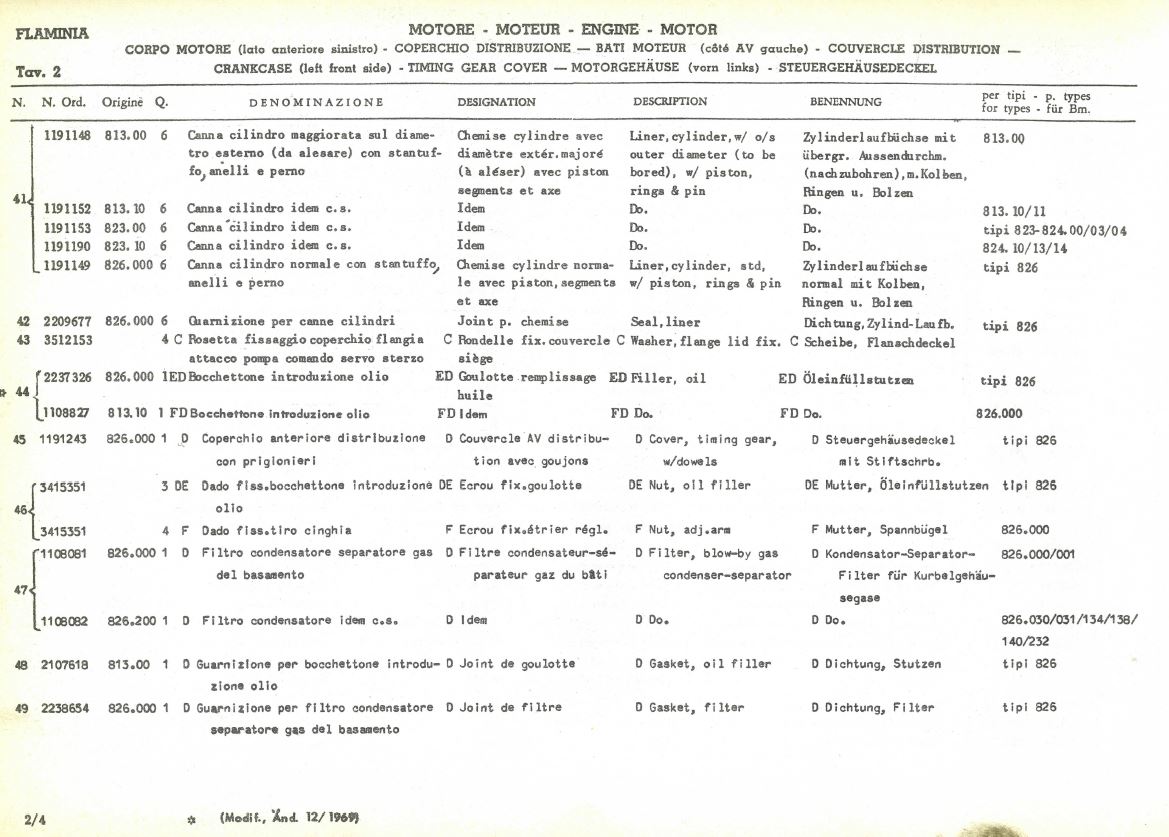

Pos 42 for 826 series only according to the spareparts manual.
- knipsel2.jpg (155.74 KiB) Viewed 744 times
- knipsel1.jpg (196.17 KiB) Viewed 744 times

I think there's a very thin seal under the liners (paperthin)
