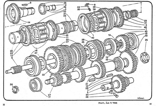

I am using a series 1 Flavia 1500 saloon gearbox for donor parts for my 1800 Coupe gearbox build and have stripped it down to extract the bearings. I am assuming the 1800 Coupe gearbox is close in design to the earlier unit but I only have parts books for the 815 saloon and the 819 series saloon and coupe. I note that the spreadsheet file Lucas kindly sent me lists the 819 bearing exchange numbers but that is a very different unit with one piece casings. Does anyone know if there were bearings different to the 1500 used in the 1800 Coupe gearboxes? I know the input shaft is different (smaller spline) but does it go further than that?

Hi Michael,
I saw your posting come by. As it happens I have just been sorting the bearings for a 1300 Fulvia S1 coupe gearbox and a 1600 S2 gearbox. I used that spreadsheet and found it has errors. Not Lucas his fault. He is the friendly and helpful messenger.
I ended up carefully cross checking with the appropriate parts books which turned my brain into a collecton of spinning bearings. I am not sure I have everything right.
Most bearings are standard. The end bearings are not. That is for Fulvia. I don't know about Flavia.

Re: Flavia Gearbox bearings
If I understand it right, I will receive an adapted XLS sheet when done?
Thanks in advance.
Pos 18 is different for the listed types according to the partsbook.
Thanks in advance.
- knipsel2.jpg (173.4 KiB) Viewed 1220 times
- knipsel1.jpg (38.12 KiB) Viewed 1220 times

Hi Huib. Thanks for the advice. I found the spreadsheet useful for updating the standard bearings to recent manufacturers numbers but it only had fields for the 819 series which is a very different unit to the split case four speed 815 unit. I too am learning as I go and I will provide a list of bearings and seal numbers once I have all the correct parts in one place. I get the feeling most Flavia owners leave their gearboxes alone or replace tired units with better ones. Unfortunately that option is not available here and I have to fix what I have. There was a cheap Flavia box for sale in South Africa but it may be as bad as the one I have got.
