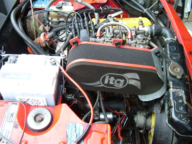

You are right with the socks on. They are only open for the picture. The is normaly a cover on it.
Like they use on formular cars. The add. pic.showes it on the car of the "old" solex carb owner .
Andreas
Andreas
- lancia_teile_004 (2).jpg (89.26 KiB) Viewed 661 times

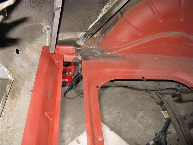

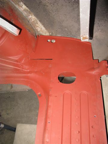

a little bit boring here today
new pic´s
Andreas
new pic´s
Andreas
- img_1212.jpg (34.13 KiB) Viewed 662 times
- img_1210.jpg (37.59 KiB) Viewed 661 times
- img_1207.jpg (65.31 KiB) Viewed 662 times

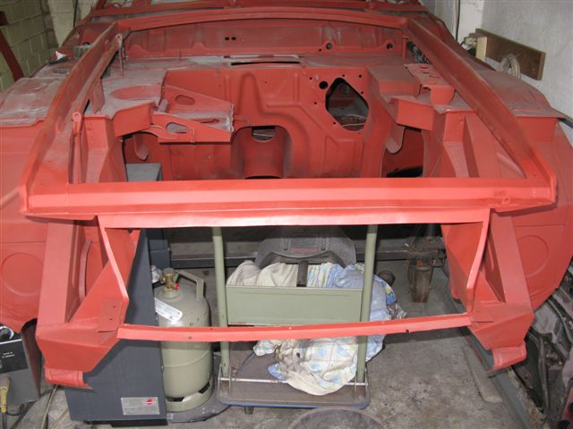

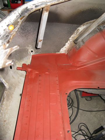

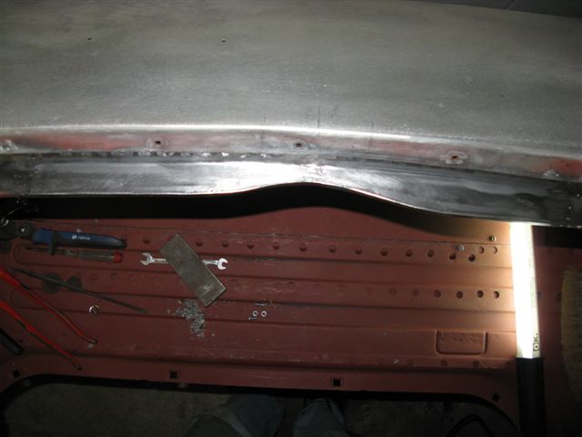

Re: Aldo Broverone's Opinion on Fulvia Sport

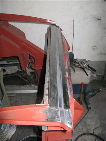

new update from the week end ( was very cold )
- img_1224.jpg (57.24 KiB) Viewed 661 times
- img_1220.jpg (33.2 KiB) Viewed 661 times
- img_1216.jpg (59.72 KiB) Viewed 661 times
- img_1219.jpg (57.83 KiB) Viewed 661 times

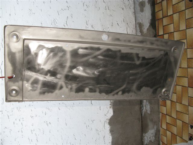

As said by others: Nice work Andreas! I'm really enjoying your progress and craftsmanship. I've got a late series 1 Sport 1,3 (chassis #818.332.2183) thus steel panels with alu doors and bonnet. It is quite sound at the moment. Given the underlaying construction however, which in effect is a huge corrosion trap, I,ll expect to do a simillar project like you in about 10 years.
Just for curiousity: What material is used for your hatchback door and your spare wheel door? It's wide spread "believed" that for series 1 and 1,5 all moving parts are made of alluminium. I've never seen both back doors in aluminium though, not even on aluminium cars. Also the part table doesn't state different matrials used.

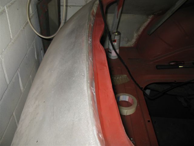

the hatchback and the spare wheel door´s are in steel. ( strange )
spare wheel door enclose ( not ready but with out paint )
- img_0903.jpg (50.46 KiB) Viewed 661 times
I have 3 Zagato's with spare wheel doors, one car all peraluman, but the door is old rusty iron.
So I have reason to believe that the back doors were never in Aluminium.

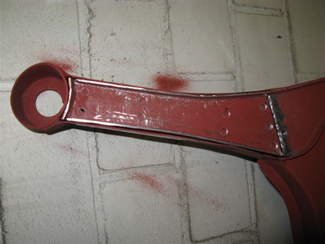

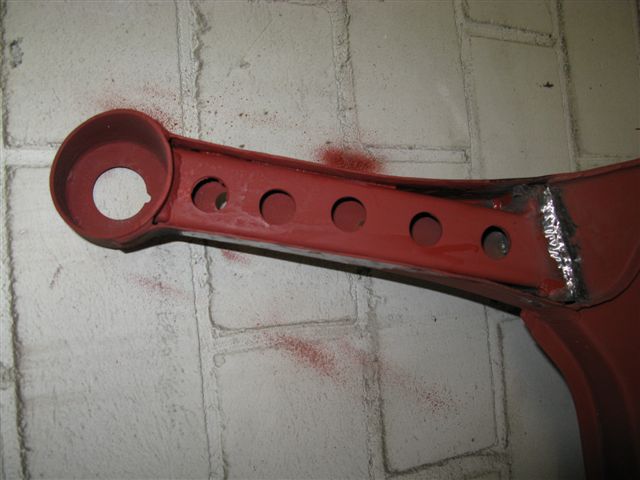

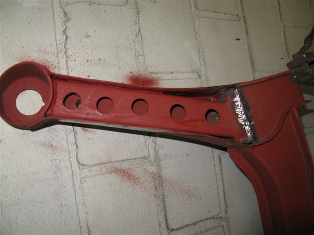

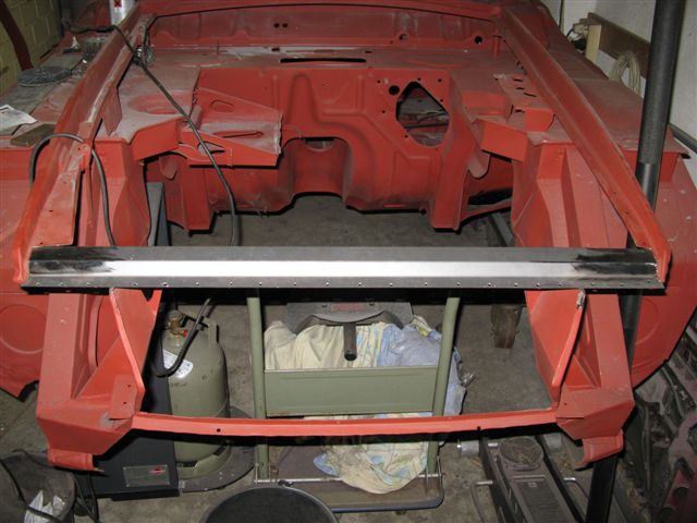

You are right, it´s to cold. So the progress is slower as i wish.
But i have worked on the subframe. Complett blasted and strengthen the bad end´s
Enclose you will see it on the pic´s ( done at - 5°C )
Regards Andreas
Regards Andreas
- img_1294.jpg (47.68 KiB) Viewed 661 times
- img_1293.jpg (44.85 KiB) Viewed 661 times
- img_1292.jpg (45.05 KiB) Viewed 661 times

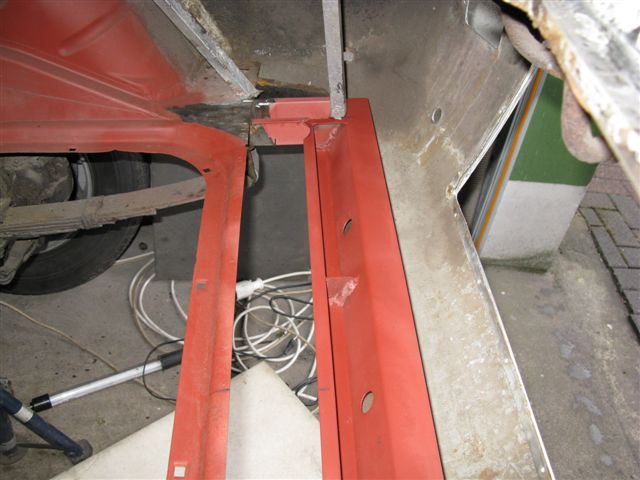

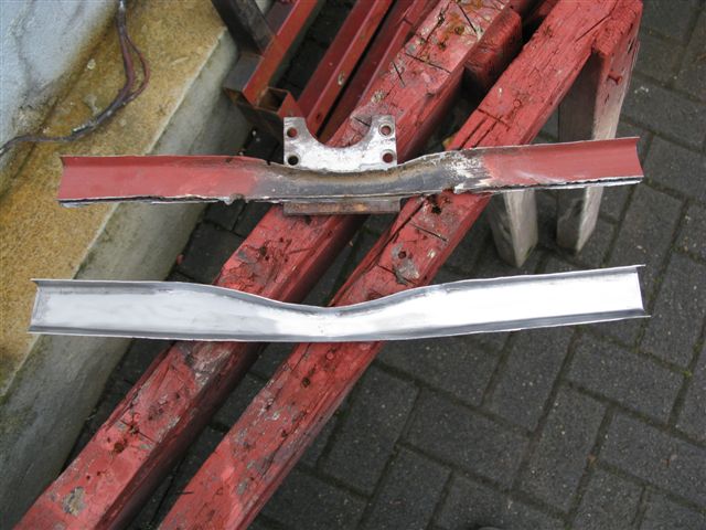

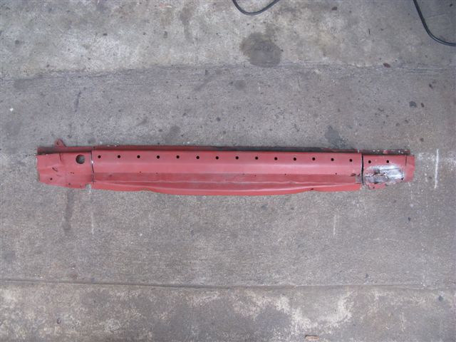

some old pic´s but i think usefull
- img_0956.jpg (27.71 KiB) Viewed 661 times
- img_0955.jpg (34.96 KiB) Viewed 661 times
- img_0923.jpg (52.59 KiB) Viewed 661 times
- img_0922.jpg (54.75 KiB) Viewed 661 times
