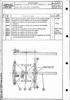

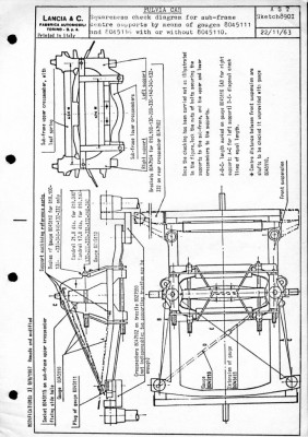

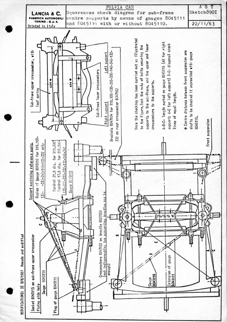

I uploaded some pictures with dimensions and tools.
Fulvia S1 subframe measurements

I just ordered the beams to built the jig today, so later I'll have a solid tool to take accurate measurements and straigthen the subframe. Unfortunately I don't understand what you mean with "point 1C". To which drawing are You referring to?
Another question: when I posted the DT with body measurements You mentioned that the line named "HO" is not the position of the fron subframe mounts. Do You know what HO is referring to?

You are right. The subframes have the same sizes. It is just that the deformation of subframe will not match deformation of body.
I just asked Wainer. The H.0 line means Altezza 0, height 0.

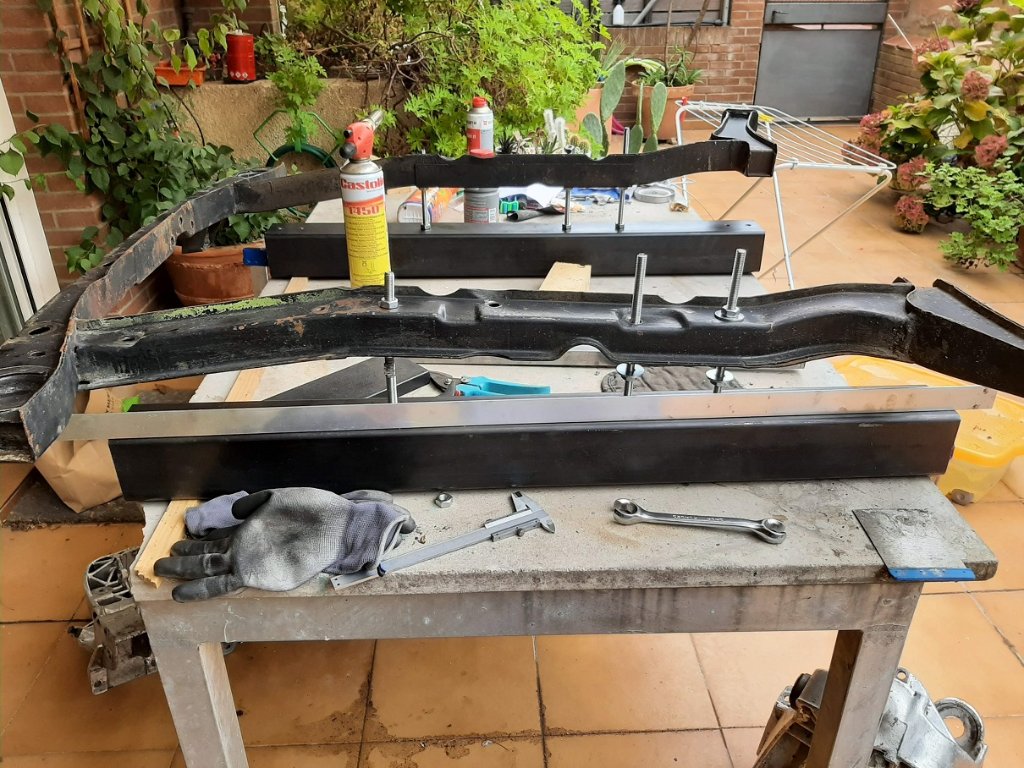

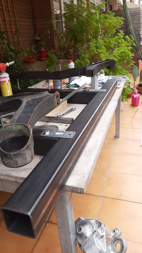

so the jig is nearly ready. I fixed the 2 longitudinal beams at +80, and when I measured the front offset it turned out to be very close to 47 mm. What a relief. It would have been hard to move it. It definitely paid off to have a very solid reference. The 2 beams were also twisted and not parallel, but I got them parallel torquing the screws on the jig. Next step is getting the outriggers to behave, they are so much off... The height compared with the longitudinal beams should be 80+2.5, but they are at 93 and 95mm. I hope I don't need to pull the acetilene.
I'm quite surprised that the outriggers aren't wleded on the top and bottom junctions, but only on the vertical ones, that does not help to keep them straigth and definitely adds flexibility. Flexibility is good until elasticity applies!

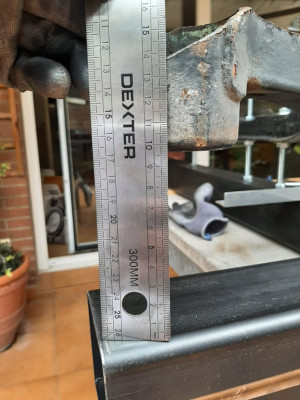

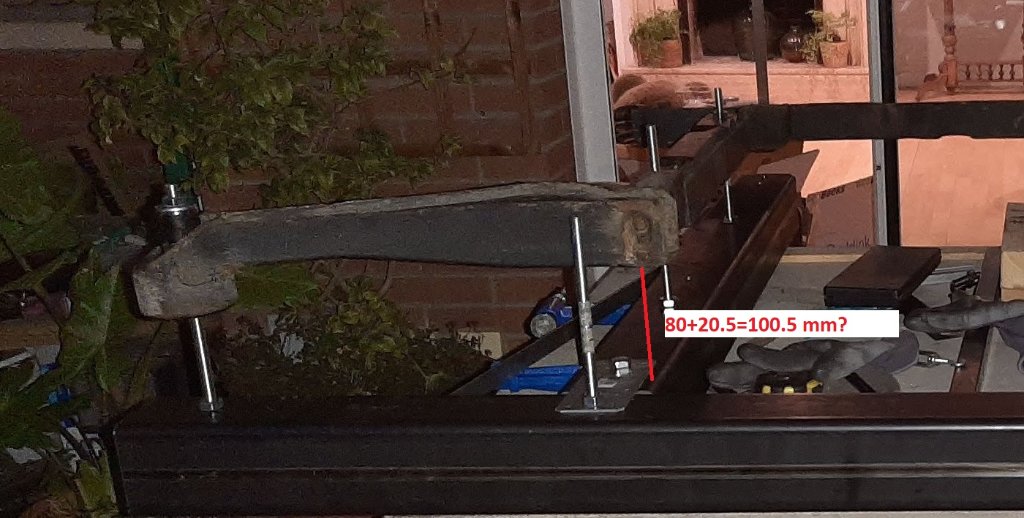

ok, so the jig is nearly completed. Am I correct assuming the height I've indicated in the picture is the -20.5 mm offset? I need to add a support there otherwise it will twist the longitudinal beams instead of the outriggers.
and by the way the subframe is so easy to bend! I was surprised to see how little effort it takes to lower the ourtiggers more than 10mm. My hope is that I can bend them back in spec using bolts and nuts.

i've been watching your progress on this project. one of the things to remember about metal is that it has a memory. if it's been moved from it's original position it will want to go back there again. but it usually takes a little overbending to get there as it will spring back after bending. when i make a fixture for indexing assemblies like this i will weld the fixture, brace it, and add the pickup points that are needed to ensure the alignment is correct. the idea being that the finished part will sit on the fixture in perfect alignment with no clamps or bolts required. certainly during the process of bending or pushing the metal back into position some amount of clamping or levering is required but in the end there must be no stresses on the part as it sits on the fixture.
it's perfectly ok to use heat to help you attain your goal too. heating the part will relieve some of the stress and help the part relax into it's position. not sure how huib feels about the outrigger mountings but i think i would weld them all the way around to add a little strength.

the goal is indeed to overbend it a bit to make sure it will eventually rest in the correct position with no effort.

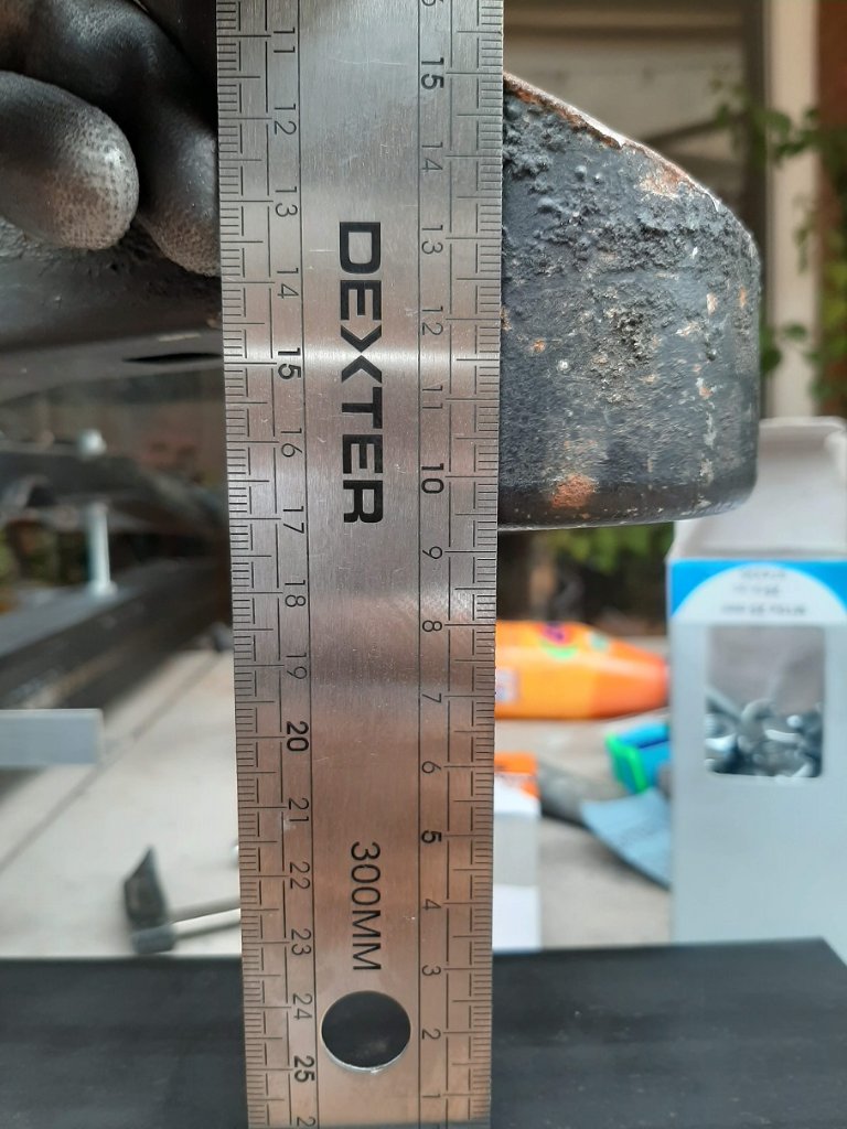

The 2 longitudinal beams were far from parallel and I had to overbent them a lot before I could get them parallel again. Now they sit parallel even if they are not clamped. I'm planning to to the same with the outriggers, but I need to make sure that it bends in the right spot. I believe I need to add a vertical support where the outriggers is welded to the main beams to make sure it bends back to the correct position but it does not twist the logintudinal beams.
So far when I bent them down to 82.5 they just sprung back to 95mm also after heat was applied.
