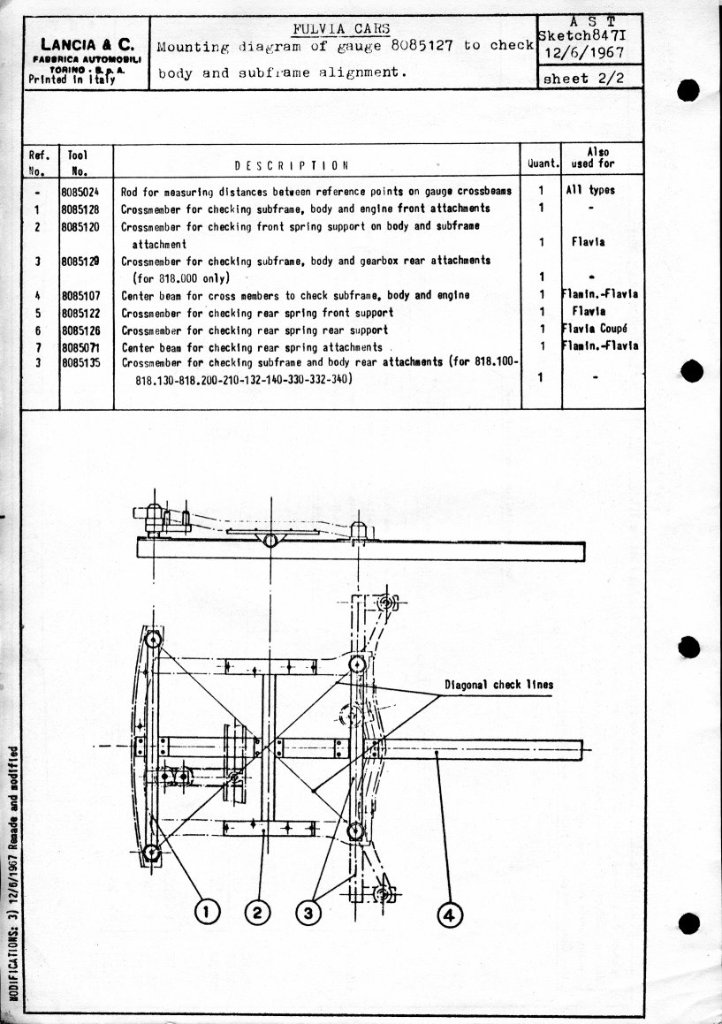

I uploaded some pictures with dimensions and tools.

I just ordered the beams to built the jig today, so later I'll have a solid tool to take accurate measurements and straigthen the subframe. Unfortunately I don't understand what you mean with "point 1C". To which drawing are You referring to?

ok, so the jig is nearly completed. Am I correct assuming the height I've indicated in the picture is the -20.5 mm offset? I need to add a support there otherwise it will twist the longitudinal beams instead of the outriggers.
