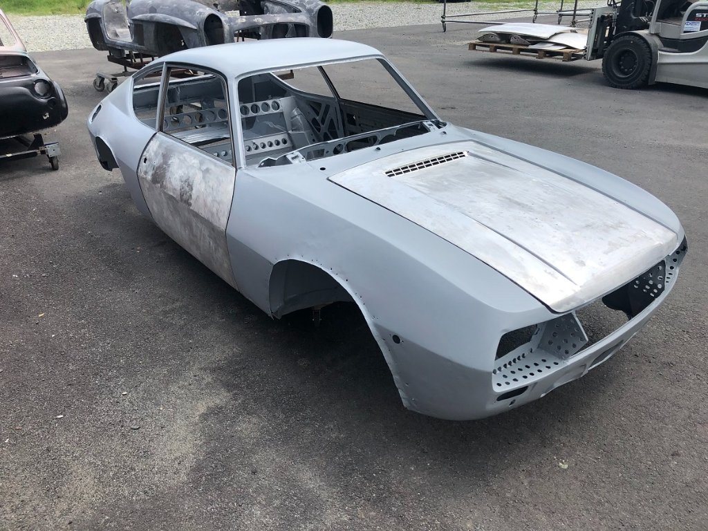

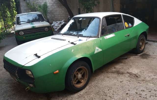

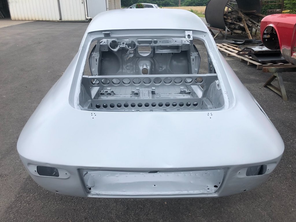

The car is fully stripped (by pyrolisis), and both inner and outer left sills will be replaced together with both rear frame support mounts. This is a former Gr.4 car that has never been used on the road and was parked in '92. It has quite a racing pedigree that includes 5 targa florios. There is relatively little rust on the body, but lots of spot welds are gone, and the body will be seam welded.
This is the car as I found it, it has got most of the original Gr.4 parts.
