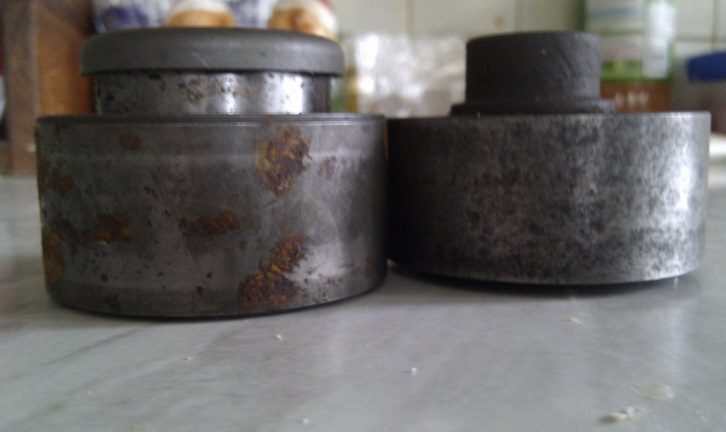

Greeting,
apologies for english only.
original tensioner bearings 57mm x 35mm x 25mm
Lancia Delta 16v bearings 57mm x 33mm x 26mm
same height mountings
Geoff
Geoff
- tensioners1.jpg (171.41 KiB) Visto 355 volte

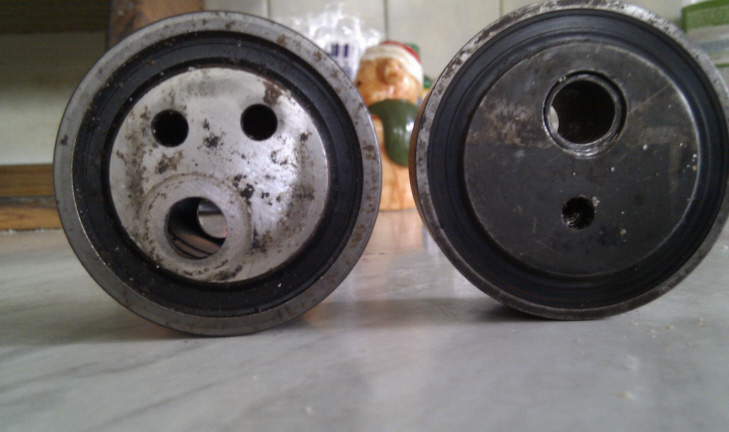

Re: Cuscinetti distribuzione e cerchi da 15'
picture 2
best regards
Geoff
best regards
Geoff
- tensioners3.jpg (184.81 KiB) Visto 355 volte
