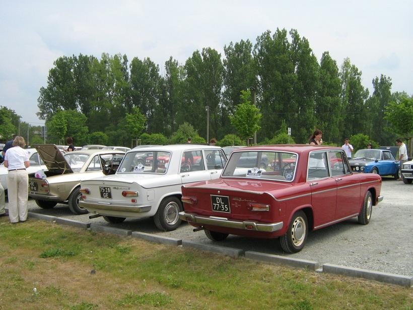

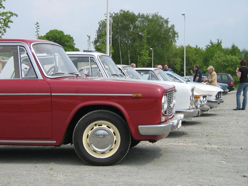

Each year Viva Lancia Bart, Huib, Lucas u.a. organize a *very exciting* Fulvia Meet in BeNeLx / NE France.
All years & models of Fulvia are present; + some "guest visitors" in other wunderbare old Lancia.
We are told to expect relaxed cruising, for short distances, on wide open roads. This is never true !
The routes taken are never any of those things, thank heavens. Wide Open Roads are not for Fulvia.
The up-hills/down-hill routes taken are a challenge for anyone to drive, in any car & the speeds required to keep up with the leading cars are yes, *very exciting*. I, who don't own a Berlina (yet) have been told by numerous Berlina drivers at this event ..."huff puff"...I really had to really drive as really hard ..."hufff puff"...& really quick as I really could to keep up with the "hufffpuff" HF's & MC's".
I, in a 1.3S Zagato, really had to really drive as really hard & "huffpuff" really quick as I could to keep really ahead of the Berlinas, that were really trying to push me off the road.. :). My co-drivers have often made noises that could be described as either "ultimate automotive joy" or "blood-curdling screams of fright" or both !
Either the Berlina drivers were really quick (true) or the rest of us were really slow (not true).
In any case, the Berlina did "huffpuff" very well !!!
OK, this wasn't in the Alps...but in terrain similar to Nord CH/ Süd Bayern. Dry, wet, dusty; country roads, dense forest trails & bumpy farmers paths (watch out for the chickens please)...that is where the Fulvia shines ... regardless of model !
