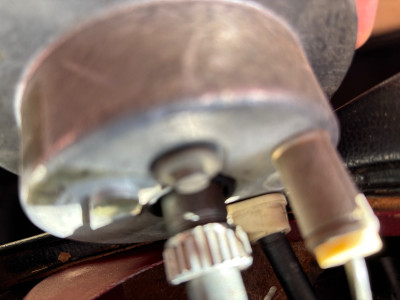

Re: Adjusting Jaeger speedometer
Unread post by Perthling »
Evidently my Jaeger Speedo is different from yours. While mine has a screw in the back, adjusting it achieves nothing. My Speedo continues to read high (80kmh displayed at 60kmh verified by my gps speed app).
