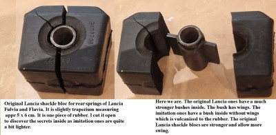

In the meantime let's define some words. What I call shackle block is this:
It is at the top of the shackle hidden in the member above the spring.
I am working on producing it with the highest quality natural rubber and the proper hardware inside.

That is what the conversion sets as on the picture in this thread do. The sets in the Lancia aftermarket I don't like as I wrote earlier. Also the length of the spacer bushes is not correct in the aftermarket sets. I make the sets myself and sell them either with or without the silent blocs. The silent blocs shown in the picture are the better aftermarket ones.
This morning I did the final test of silent bloc prototypes I had made with top quality rubber and steel. They are approved. An hour ago I ordered a large batch. Interestingly they are more than 100 grams heavier than the standard aftermarket units.
You can buy from me the shock absorbers (https://viva-lancia.com/specials/de-car ... carbon.htm), the conversion sets for the front, high quality silent blocs for the wishbones and hopefully soon the correct shackle blocs.
