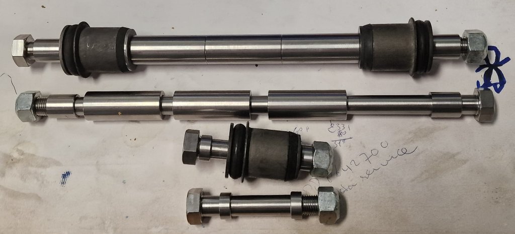

Conversion set to convert Fulvia S1 and Flavia's to silent blocs from greased bushes.
This set is for cars without power steering.
Counting from the top.
nr 1. Complete set for one top wishbone including silent blocs. The silent blocs are standard Lancia. 2 are needed per car.
nr 2. Stainless steel bolt and bushes. Small bushes to convert the hole in the arm from 18mm to 14mm. Bigger bushes to go in between the silent blocs. The thread is metric fine. The threaded part is just short enough to guarantee that the unthreaded part bears in the hole. The nut is zinc plated all steel self locking grade 10.
nr 3 and 4 are needed for the lower wishbones. 4 are needed per car.
The Flavia's with power steering need a longer bolt and bushes at the top. That set is made to order.

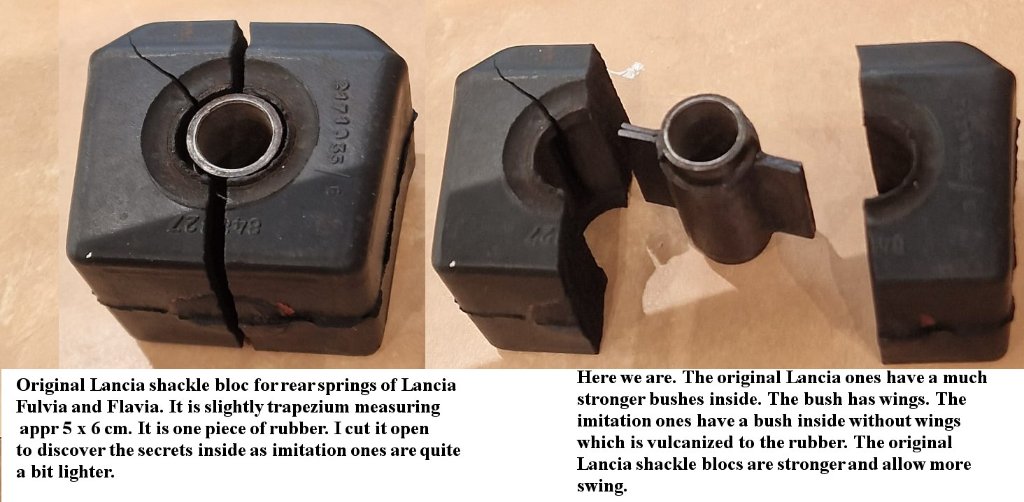

In the meantime let's define some words. What I call shackle block is this:
It is at the top of the shackle hidden in the member above the spring.
I am working on producing it with the highest quality natural rubber and the proper hardware inside.
What I call bushes are the things which can be taken apart, rotate more than 360 degrees and usually greased.
Silent blocs consist of two bushes with rubber in between. They cannot rotate more than 15 degrees one way and 15 degrees the other way. Total swing 30 degrees. The rubber does the hinging. No friction. No greasing. Reduces vibration.
Standard quality: the rubber is pressed between the two bushes.
Lancia quality: the rubber is vulcanised to the bushes.
