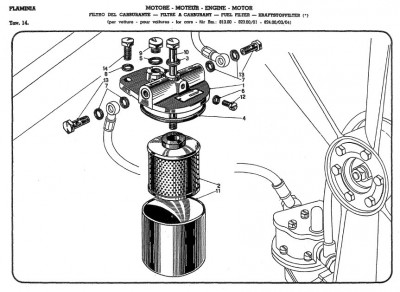

if I'm not wrong, the 823.02 (3B 2,5) and 826.030 (3B 2,8) are equipped only with the filter inside the electric Bendix fuel pump, the big external FISPA fuel filter type 40-10960 is for berlina 813.00, coupè single carb 823.00/01 and 824.00/03/04, the small FISPA filter with regulator type FRB 11.3064.07 is for 824.10/13/14 and 826.132/134/138/140/232 as you can see in the attached tables from spare part catalog.

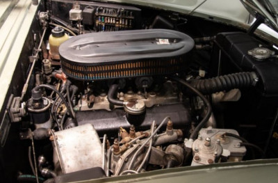

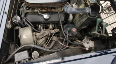

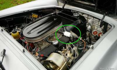

I saw some pictures of 3B 2,8 equipped with regulator filter but I guess are not original. You can see in the other attachments that filters are not installed in the same position.
I my 2,8 3B there isn't any FISPA filter in the engine bay.

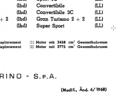

The manual in my hand is version updated 4-1968, could you please give me the reference of your manual?

I think you are correct and I made a mistake reading the parts manual. I checked my manual and it is the same as yours, FISPA 40 for 813.00 and 01, and FISPA 11 with regulator for for 824.10, etc.
