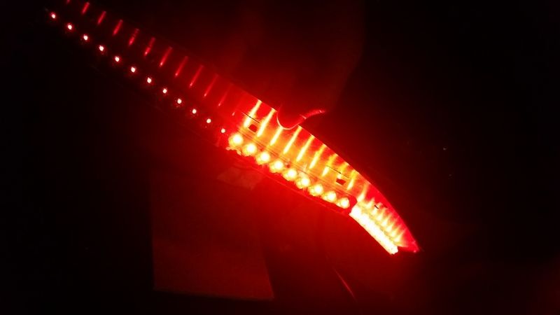

Here are some pictures of my repair work. Lower part of leds were working on half power. Picture is "upside down" because I was testing my first repair attempt and the light is connected inside the boot.

Now it is repaired and it works correct. Not a fun job to do, but it can be done.

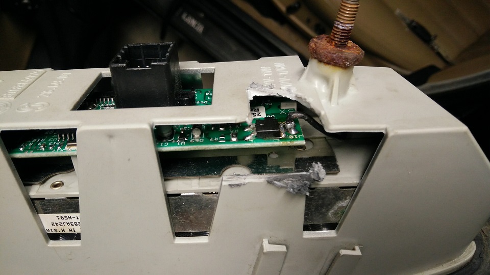

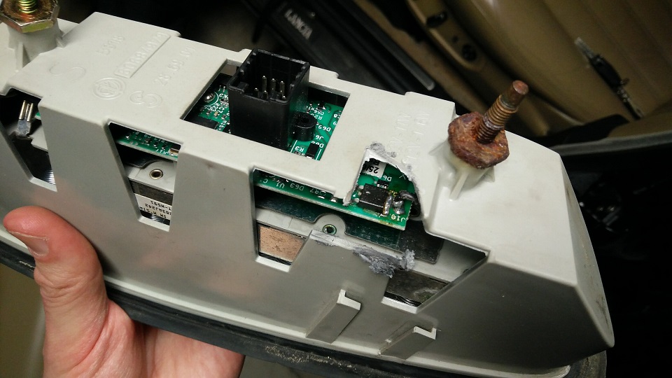

Repair update:
left rear light was again acting wrong so I made quick'n dirty repair work. I noticed that one wire caused all problems when twisting it a bit. So, some solder work was required. I used dremel for cutting a hole, which then eliminated the need for complete disassembly.
Black wire under transistor.
