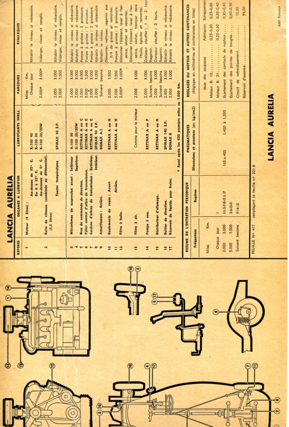

An idea. Original.
aurelia oils.jpg (172.04 KiB) Viewed 7732 times
