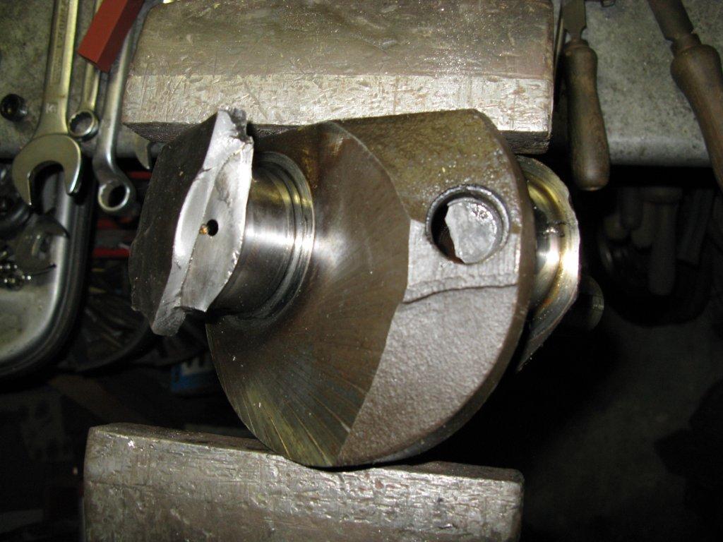

"wouldn't it be better to use a modern multi-weight and change more frequently"
It is a question of the engine status. If it was totally rebuild and cleaned ( means particularly the crankshaft, Oil channel`s and so on; )
and used modern materials ( seals etc.) i would use synthetic oil.
If not use standard mineral oil to avoid that oil mud will get in the circuit. Modern synthetic Oil has a lot of dissolvent ( hope that is the correct word )
compared with mineral oil. (See pic´s what can be inside the crankshaft )
Best regards
Andreas
