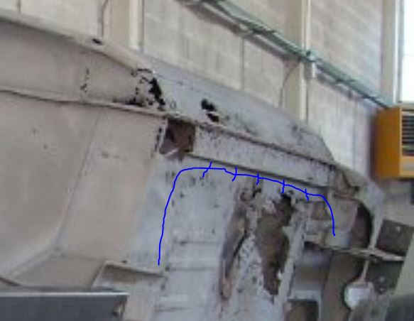

Can you send me a sketch of the internal slot? Is the internal slot part of the floor pan as shown on attached picture?
- brake_fuel_line.jpg (35.33 KiB) Viewed 1586 times

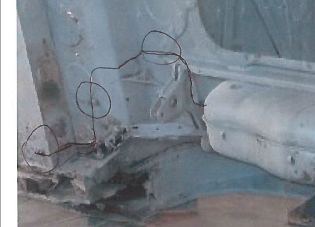

Does the attached picture show the correct fuel/brake line routing? Circles indicate where the metal hold down straps are located.
- brake_fuel_line1.jpg (39.23 KiB) Viewed 1586 times
