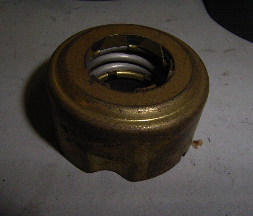

I've just returned after a holiday, a trip to the Czech republic, with wife and kids in my flavia berlina (1st series). Unfortunately, the water pump started leaking, eventually in an alarming tempo. At last I had to refill my radiator with 1,5 liter of water every 100km. Just made it home!
My water pump was a reconditioned one, with a new seal and new bearings. It has lasted less than 10.000km.
I have now dismantled it:
The rotor is badly scored, and the bearings are scrap. Surprisingly the seal looks like new (see photo)! This seal looks like a modern one; could it be that the original Lancia seal had a larger contact area? Is this seal still available?
I have dismantled two other old scrappy pumps (very difficult to get the axle out of the rotor). I managed to flatten the least damaged rotor, as you can see on one of the photographs. Has anybody advise? Availability of a new seal?

Re: water pump
Hi Hein,
would you please send me the dimension of the non original seal that you dismantled. Here in Italy is quite common to repair these pumps using some FIAT seal that is quite easy to find on the market (I have some pieces of it), but I need to know if the seat is the same of yours.
I'm actually abroad but, next week I'll be able to send you some pics.
Kind regards
Giovanni
Kind regards
Giovanni
Hein Reedijk
- Posts: 174
- Joined: 21 Dec 2008, 20:00
Re: water pump
Hello Giovanni,
Thanks for your reply. The outer diameter of the seal is 36,5 mm on the bearing side, and 32,5 mm on the rotor side. Inner diameter: 17 mm.
There is a number on the back of the seal: "5". No other numbers.
Regards, Hein.
Regards, Hein.

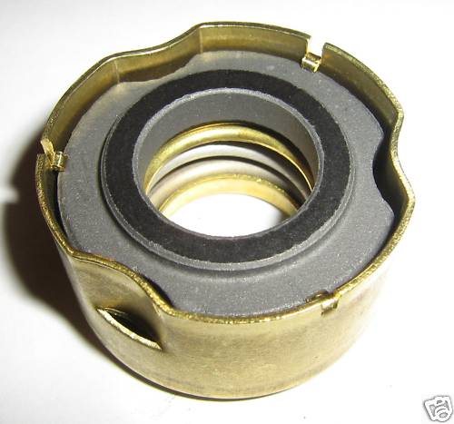

Re: water pump
Hello Hein,
also the seal that I've mentioned have a diameter of 36,5mm then you can use it without any problem. In the attachment you can find a pic of the modified pump and two pics of the seal. Due to the fact that I have only one piece and I need it, tomorrow I'll try to find another one for you. Please send me by private message your postal address and I'll send it to you.
Kind regards
Giovanni
Kind regards
Giovanni
- waterpump3.jpg (49.78 KiB) Viewed 1582 times
- waterpump2.jpg (83.32 KiB) Viewed 1582 times
- waterpump1.jpg (90.87 KiB) Viewed 1582 times
Hein Reedijk
- Posts: 174
Re: water pump
Hello Giovanni,
I've sent you a PM. Thanks a lot, also for the pictures. This seal looks a lot more sturdy!

Re: water pump
I have reassembled my water pump. Giovanni has sent me a new seal. On ebay one can find the same seals, for example from a Fiat 127. They cost only a few euro's. The seal will not fit in all the pump housings: I attached a photo of a housing with an extra groove; the seal can not 'sink' enough in this housing. (The housing could me machined though.) Luckily I had another old pump in which the seal fitted perfectly. The bearings are of the 6201RS type: 12 x 32 x 10mm.
[The extension has been deactivated and can no longer be displayed.]
- reassembled water pump.jpg (45.75 KiB) Viewed 1582 times
- water pump with new seal.jpg (37.1 KiB) Viewed 1582 times
- pump seal fiat 127.jpg (29.12 KiB) Viewed 1582 times
