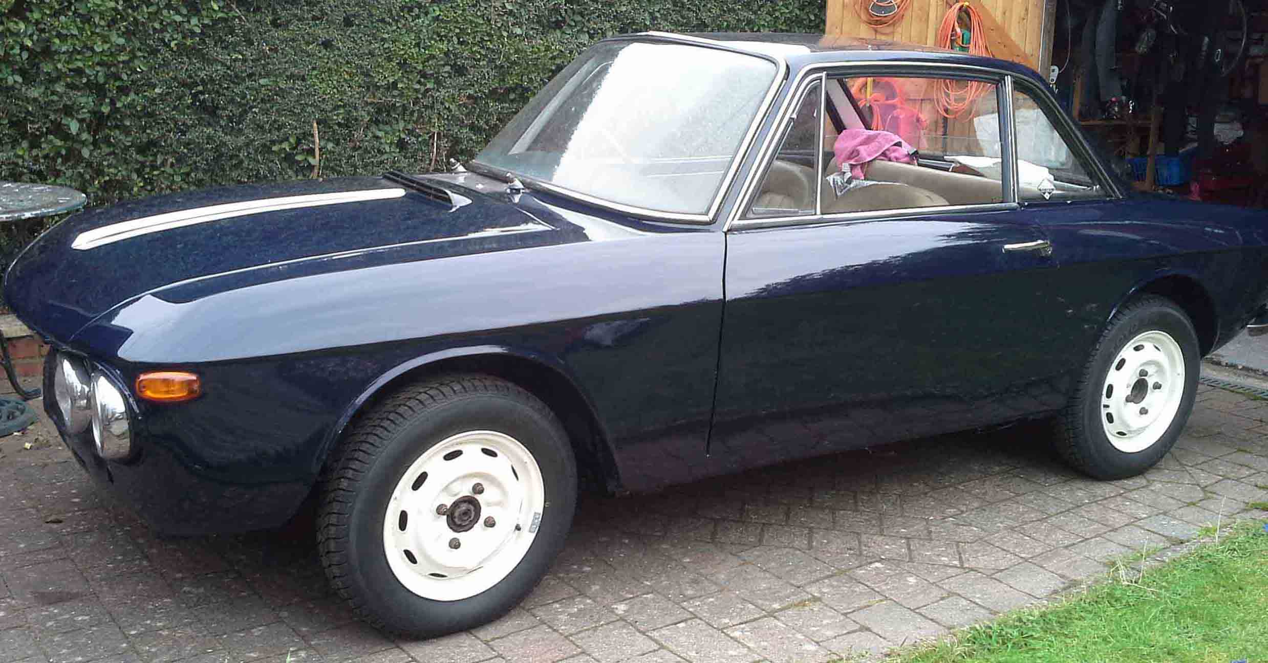

Hello Georges,
Fantastic photo... a real inspiration to finally finish my car and sample the delights of Europe. I attach before and current photos of my car. I can now weld!!

Nick, your pictures makes me remember the beginning with my own car, about 15 years ago....Same colour
Courage !

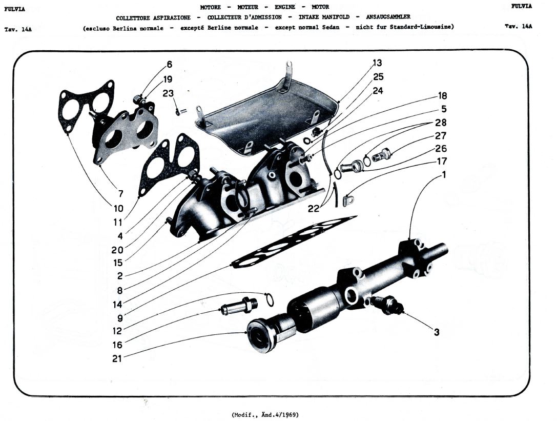

Huib, I do not see this tray on the schemas of technical documentation for the S1 coupé but it is shown on that for S2
I understand your recommandation, it does not seem difficult to install a sheet of aluminium, I just have to find a system to fix it in place (I have no memory of such a part in my spares)

Drip plate for S1 (pictured the 1.6 HF version with alternator.)
Picture from S1 parts book
- knipsel.jpg (122.08 KiB) Viewed 919 times

About "the paratia per carburatori" called "cloison" in french and "collector" ?? in english : I did not search on the right page of the doc : it is shown on tav 14A part n° 17
I have to dive in the many parts boxes to extract that forgotten part !

Re: Alternator conversion - Lancia Fulvia series 1 Rallye S
Thanks for the picture, I finally foud the equivalent on the CD doc about S1
I have now to find that piece...forgotten in my spares parts ? , or elsewhere
