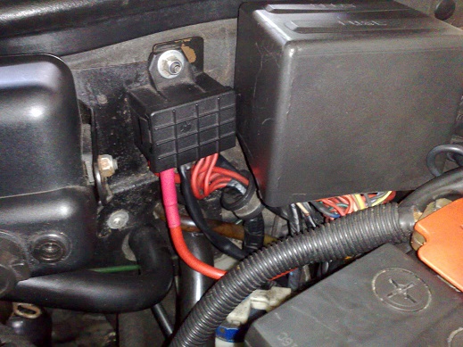

There is a central location where all the fat + cables come together:
You can open the lid and see whether the bridge inside is still working.
- 28032009021_klein.jpg (100.48 KiB) Viewed 546 times

Auf den Kasten würde ich auch tippen. (This would be my favorite too.)

I think it should be an easy check with the multimeter if the red cable goes directly from the fusebox to the small Central Connection Box.

By removing the battery we got access to the earth point on the inner wheelarch. With live feed and by moving the cable we could hear the clicking sound from differnt relays shutting on and off. The connection bracket to the inner wing is original factory spesific clamped together with the cable. Over time the clamped connection is not good enough. It deteriorates over time. The fix was to lead solder the connection. Then the cabel was screwed to the inner wheelarch again. The battery was put in place and the engine started at the first try. And the instrument, lights, wipers, and windows motor were functioning again.
It looks like the bad connection gave different volt input to the components. The instruments and the relays behaved differently depending on how good the connection was at the time. So, in the beginning difficult to interpret the fault. I hope that is a valid interpretation of the problem.

I fully agree, the mass Cable and its fixure to the body might cause exactly these symptoms you experienced with your car. Additionally this explains why the starter did not show any malfunction. This cable extends down to the gearbox support and therefore provides a separate current return path which is not influenced by that clamp connection.
