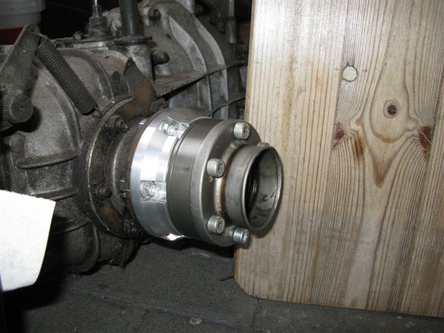

Why do´t you asked before. No Problem to explain it.
First : My opinion is, it´s not a clone of a Daytona Racing FSZ from a standard FSZ.
It is a modification by my "own spec." I do what i like and disclaim what i don´t like.
It is like ED said there are so many detail what make the difference respect to a HF ( or a Daytona)
Example, if you want install a 1,6 engine you have to use a first series one to have a Daytona spec.
I have a 1,6l second serie´s engine and i am not sure to install it in this Z undepent of original or not.
Maybe i will add. the 1,3 as it was in the car.
Also the gearbox. Dont have a fivespeed first serie but i can use a fourspeed first or fivespeed second serie´s
By the way, i build up an adapter to use the driveshaft second serie´s also with the fourspeed firstserie´s ;) `
And so on.
