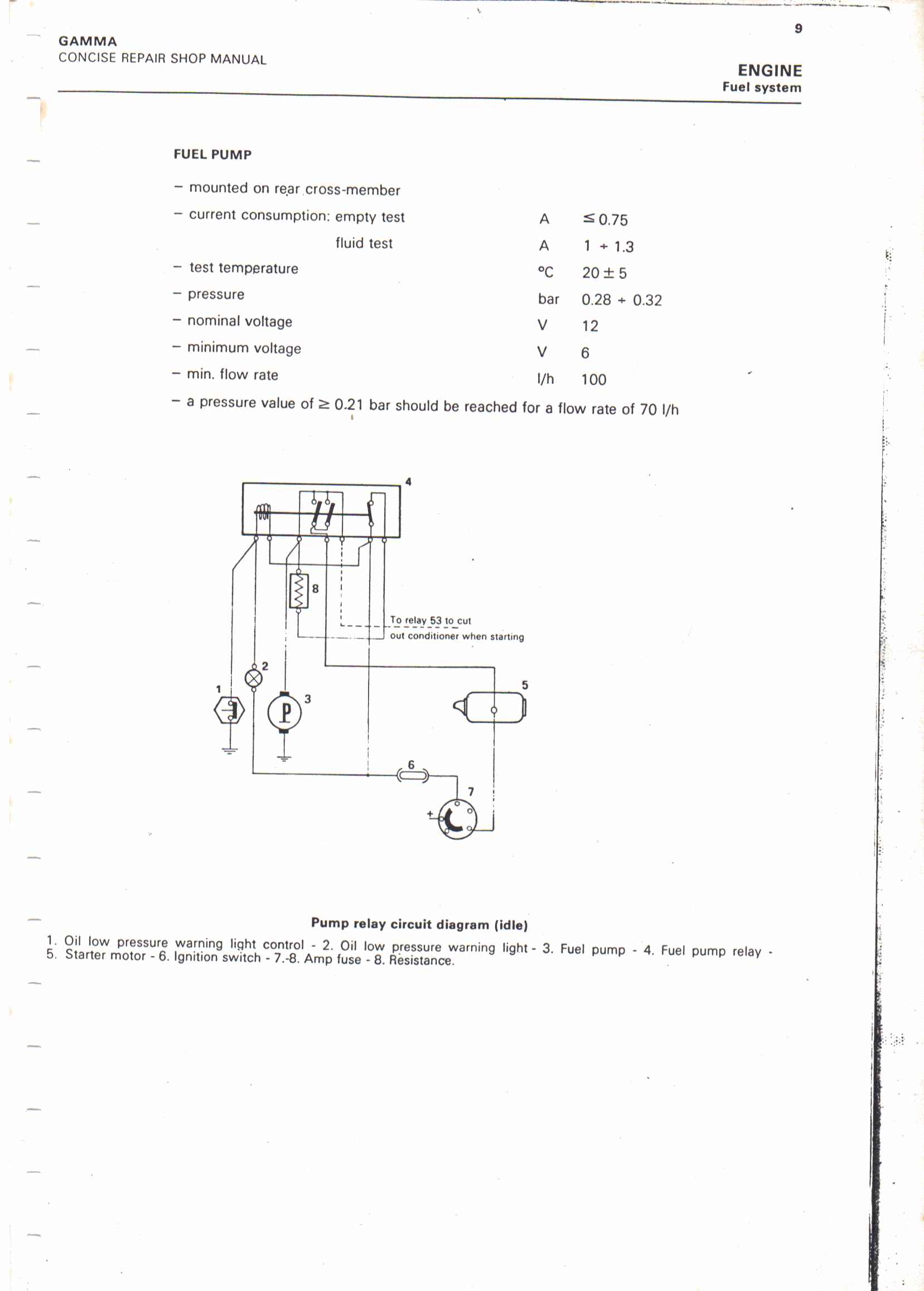

There are two units for the electric pump
one is changeover relay triggered by oil pressure switch on start
then by main power.
other unit is a resistor the value is not listed in the manual.
Geoff
(page 9 and 10 of the concise repair manual)

Markings on the two pin unit :
MA/ER Torino
3 ohm - 20w 990
Geoff

Hello Walter,
in the engine bay (under water tank) you find fuel pump relay and separate resistor.
I believe resistor is to protect pump relay to avoid backfeed to other circuit.
Greetings Geoff

scan of relay
- pumprelay.jpg (121.93 KiB) Visto 795 volte
