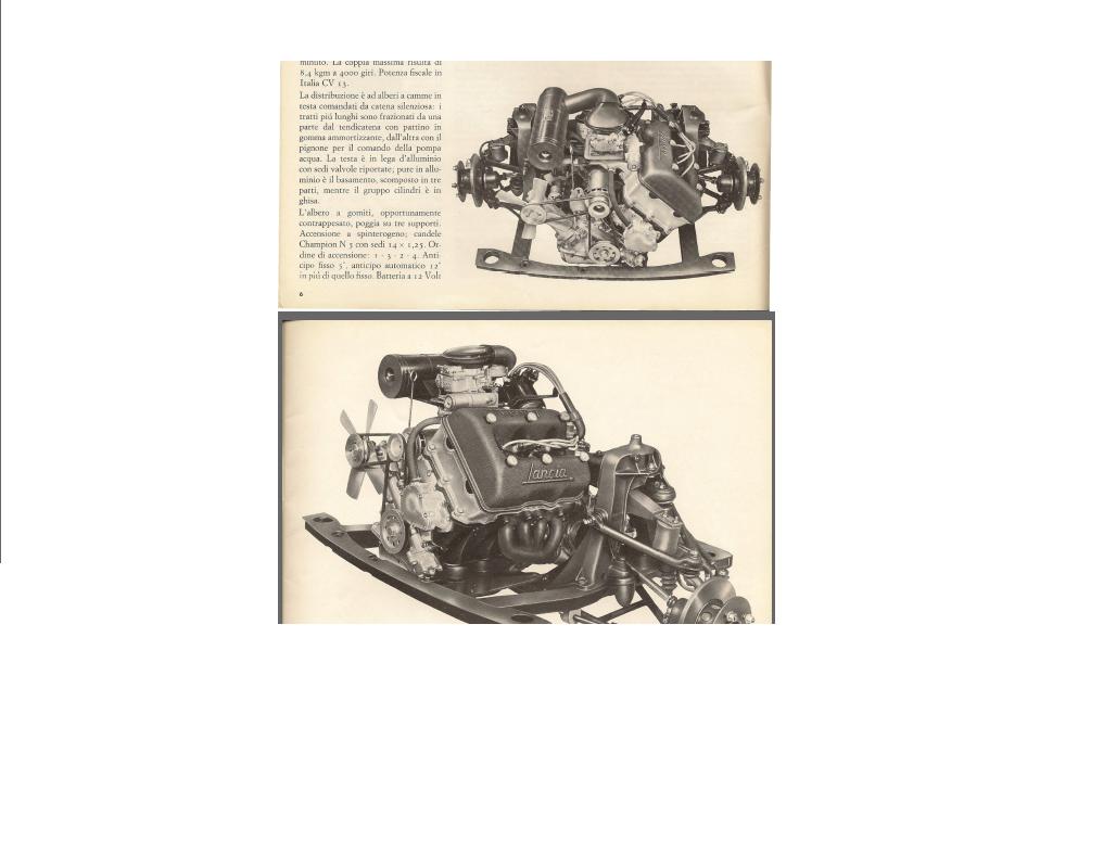

This issues cropped up a couple of years ago on the LMC forum, this is what I posted at the time (my block, 1.6HF, had plenty of eveidence of being painted grey);
"This is a photo from a 1963 Lancia booklet (Straordinario Fulvia) covering the production facilities of the then new Fulvia (berlina). It is clearly black, so would more or less confirm your conclusion.
Later Lancia technical publications I have (S2 +) all seem to show grey (or possibly unpainted). Photos in various books covering the Fanalones (particularly Altorio) show grey (or again possibly unpainted). Like you, I doubt my engine has ever been out, so am pretty convident that grey was my colour, as black would seem to be your colour.
There is also a thread here on the subject if your Italian is any good , but it does suggest a RAL code (7035) for the grey.
When the change occured and if it is different coupes to berlinas I not seen anything conclusive."
Neil

- engine colour.jpg (57.45 KiB) Viewed 1696 times
