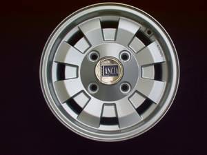

As my car is regularly fitted with 14 inches new tyres, I would like to find 14" rims
A few monthes ago, I found an information about new made rims on an US website (Mr Fiat I think)
It was described as this : (and see picture attached)
NEW - CROMODORA CD 28 ALLOY ROAD WHEEL. 6 X 14", 4 X 130 MM BOLT PATTERN, 23 MM OFFSET, WEIGHS 6 KILOS. SPECIFY SILVER OR GOLD WHEN ORDERING! we are glad to inform you we can supply the Cromodora CD28 aluminium replica for Lancia Fulvia. Size 6x14, pcd 4x130, ET 22,5, weight 6,5 kg. finish: silver. Conical bolts 14x1.5 mm, chromed center cap. 100% made in Italy, with accessories. IF OUT OF STOCK THIS ITEM CAN BE RESTOCKED FROM ITALY IN 4-8 WEEKS. TO MAKE SURE WE GET ONE FOR YOU PLEASE FILL OUT & RETURN THE SPECIAL ORDER FORM FOUNDHERE, PLUS INCOMING FREIGHT & US CUSTOMS CLEARANCE CHARGES.
This product was said to fit S1, another model is for S2-3
I was informed that after order, the rims would come to me directly from Italy to France....so I asked about the firm that really made these rims
And I tryed to find a seller in Italy or here in France, but could not find anyone
So I decided not to order
If one of you have any informations about these products, I would be happy to hear what you think
Thanks again
Georges

Re: what rims for my S 1 ?
scroll back to earlier posts; these wheels have been discussed in the forum previously
