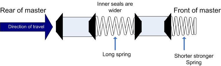

Hi, just wondering if anyone had a diagram of the internals of a series 1 18mm brake master (Zagato 1.3s).
Just need to confirm that the one I rebuilt has the seals in the right order. I obtained a spare master and found one seal the other way around?
I've attached a diagram I drew of how I think it should be. Would appreciate any assistance.

Your drawing is correct.
The rear seal on the 2nd plunger counting from the pedal is reversed as it receives pressure from the chamber between the two plungers.
