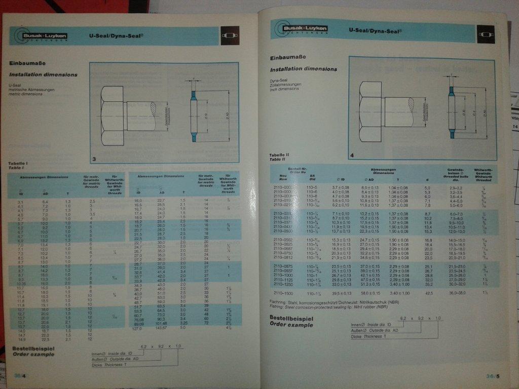

Supplier of seals online?
Hello,
Does anybody know a webshop or company in Holland who supplies the U-Seals?
Kind regards,
Tom
Kind regards,
Tom
Re: Supplier of seals online?
some years later B)- enclose the drawings and add. the U-seal from Busak & ...
regards Andreas
Try on ebay usit ring
regards Andreas
