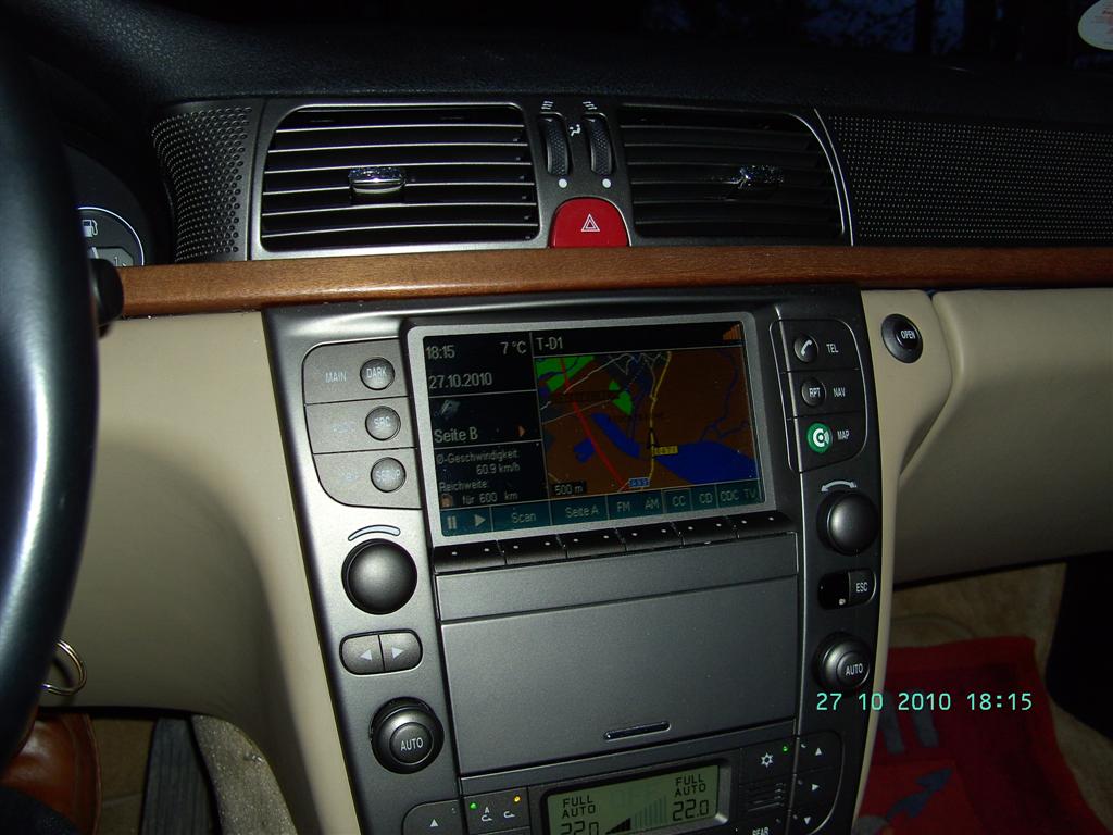

hi all
please use the examiner to find broken sensors etc.
i have the same prob. just in connection with the EPB.
this week i have my car under investigation!!!!!!!!!!!!
joke off
joke off
- lancia freunde stammtisch okt. 030 (large).jpg (110.2 KiB) Viewed 4020 times
Re: Skyhook problems
hi all
we have found 2 broken connections per computer.small version for a little garage.
it was a simpel disconnection.
now everything is working fine. no more epb or any msitake.
no low voltage !!!!!!!!
