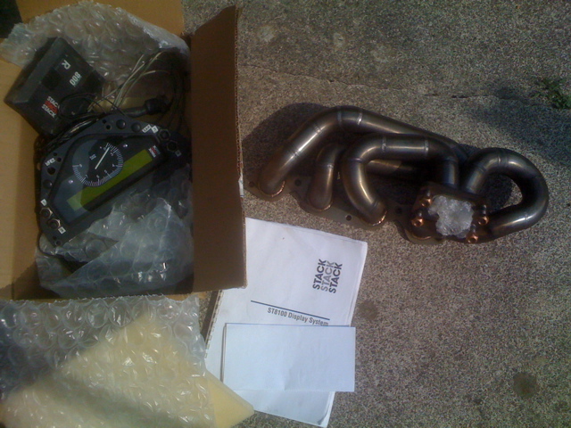

stack dash (with recorder and various 52 mm dials saved from wrc car) and a one off manifold from italy..see pic 2
rally project manifold and stack display kit (ex wrc)

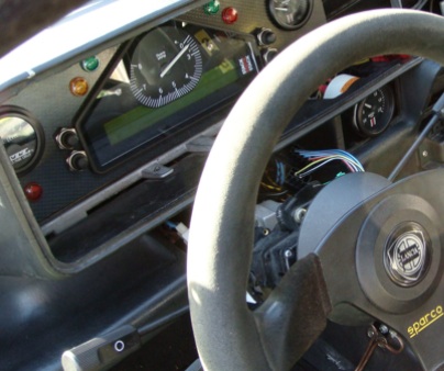

fitted dash and manifold.
standard sensors tapped to accept the stack one's

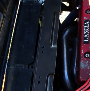

wheel speed sensor bracket made up by john brain,one diff bolt tapped and bolt fitted to give metal object pickup for the sensor,alan made up the stack loom for me with straight paths,aircraft connections and heat shields,.cosworth group A radiator fitted to give clearance for the exhaust.
stack dash warning functions are excellent,just set a level for it to go off for each selected sensor (water temp 95 for instance) and low level is the same setup (oil pressure 20psi)
no bar option so used standard dash for guide...3 bar = 44psi roughly
