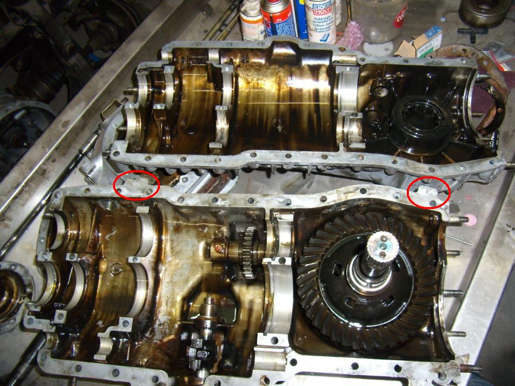

When I was assembling my subframe,
the allignment was one of the easy parts... :S
The seam underneath the gearbox is perfect position to start from.
There are on a housing halve, 2 cams cast, they can help you with the allignment. (see pic)
The other point of measurement is the inner side of your subframe.
If you can allign the gearbox perfectly, the engine will folow.
According to the repair manual, diffirence (L/R) should be less than 1mm.

- gearboxinhalf.jpg (140.31 KiB) Viewed 836 times

Thanks Bart, the real issue that I'm having is measuing from the seam to the edge of the subframe acurately while being underneath the car since the subframe is still in place, I thought there might be a trick to it but I guess I just move a bit measure a bit etc etc.... somewhat tricky though...
