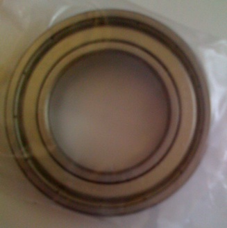

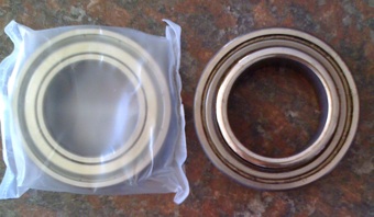

Thanks for the replies, the bearing I have here is a bit smaller, 62,36,14, I phoned another bearing supplier this morning, they said they had it, arranged for someone to collect it for me and guess what... It's not the same, it has an ID of 35 which I guess could work but the it does not have the protrusion that actually makes contact with the pressure plate!
I've attached 2 pics of them, the new one obviously in the packaging to be returned Monday first thing!

The protrusion is not a protrusion. It's an insert - you push it out of the old bearing and put it in the new bearing.
Put a bit of freeze spray around it and drift it out. Warm the new bearing in front of a heater and pop the insert into a fridge for 1/2 hr then press it in using a vice.

Does that mean that the new bearing also has this insert which needs to be removed? or should I be getting a bearing which has an ID less than the insert?
As the both bearings look identical except for the fact that the new bearing doesn't have a protruding "insert" but rather a level "insert". Both have almost identical ID's.
Sorry... to make it simpler, the insert you are referring to is actually part of the bearing and doesn't look like it could/should be removed!?

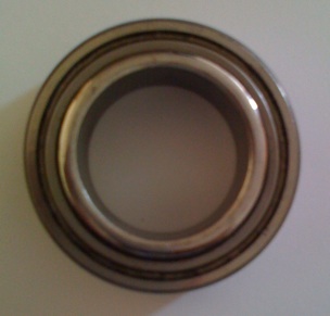

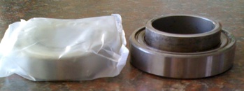

I don't see any inserts on the new bearing - all I see is an inner and outer race with a metal seal for the ball bearings.
I don't have a photo of mine in bits but all I did was turn the bearing over and knock the insert out. If your insert is actually an integral part of the bearing case then it is of a type I have never seen before and I can't help. Have you got a photo from the back?

Neil, I've attached 3 pics, top and bottom of current bearing and one pic of the "new" bearing which looks identical from both top and bottom, I might just be imagining this so your help is really appreciated!
