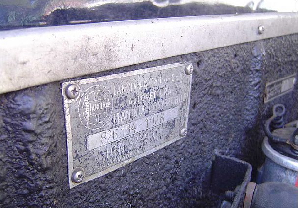

The original chassis number is on a blue plate in the engine compartment and the Touring serial number too (see the photo).
If they aren't, somebody removed them. Open the bonnet on the right side of the car: looking at the edge of the body, above the right wheel, you could see the serial number duplicated. Anyway, if you can't read it well, clean the paint with the car polish and a tooth-brush. Otherwise, somebody removed it with a file. The third chance is reading on the original registration documents.
