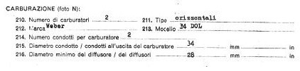

Homologation Form 534 shows that the car was homologated in Group 3 with 34DOL carbs and indeed 28mm chokes were used.
Form 1492 which is for a 1.3HF in Group 2 shows Solex 35PHH or 35DOL and 36DOL were homologated.
Where on earth am I going to find 34,35 or 36 DOL carbs?
Help!!!!! please.

Solex 35PHH should not be a problem.
This are the normal production carb´of 1,3 l engine.
regards Andreas

Like the 1300HFS which was factory fitted with DDHF40's with 34mm venturi so was the 1216HF with 77mm bore (making 1248cc) factory fitted with the same DDHF40 carbs.The problem being that also these carbs are not available. This 1200HFS was not available to the public compaired to two years later the 1300HFS which was. It seems that if you have to stick to the group 3 regulations only the Solex 35 with 31mm venturi can be used as biggest period option. I doubt it it you can make more than 100Hp with them. I have basically the same engine in my 1200HF and with 35mm carbuterrors max power seems to be around the 6500rpm mark and will not be higher than about 95 DIN Hp. Experts tell me that bigger carbs are the answer.
