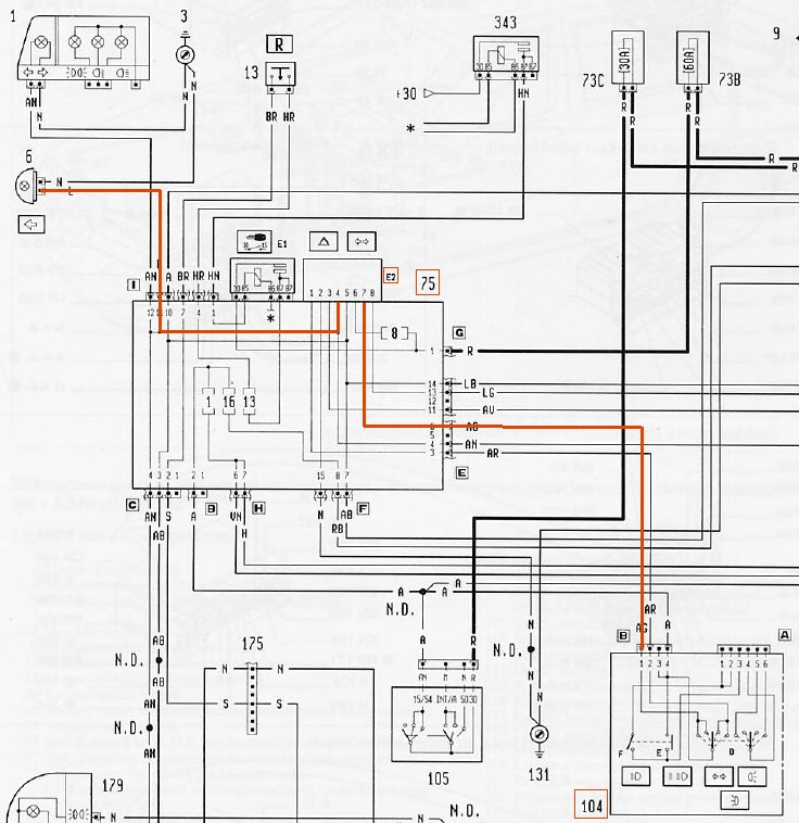

I think you have found out by now that it was a faulty indicator stalk.
Pictures might help finding the components envolved.
104 represents two stalks
75 its a big electronic box below the driving wheel
E2 seems to be the electronic flasher
- 2.jpg (55.58 KiB) Viewed 648 times
- 1.jpg (101.22 KiB) Viewed 648 times

i found the cause of the problem, bad connection at the indicator relay.
