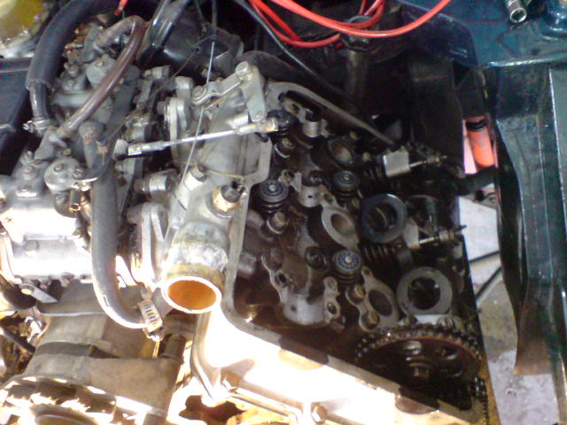

My 1600 HF has been making an awful rattling sound since I got it. I had the chain replaced (It is the correct one) by a mechanic recently as I didn't have the time to do it myself.

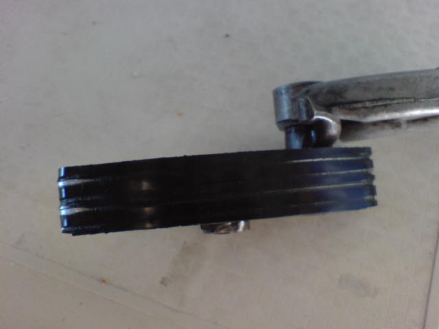

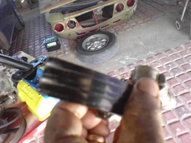

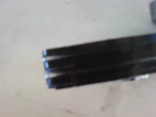

As part of the car's christmas present I set about setting the tappets as I thought that may be the problem. It wasn't, so I removed the water pump to have a look at the tensioner and hey presto the problem revealed itself. The shoe was worn through into the metal. (see pics)
Question 1. Does anyone know what material the covering is made of and whether it is possible to have this rebonded
Question 2. As I now have the motor virtually in pieces (and dropped the chain into the sump), I thought I would check the big end bearings whilst I was at the job. Does the 1600 HF use different bearings to the 1300 and if so what is the spec?
