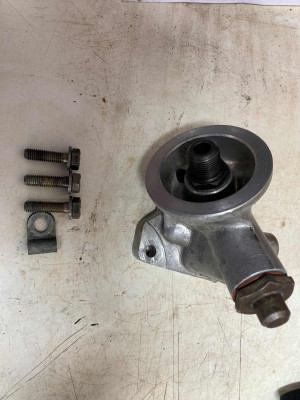

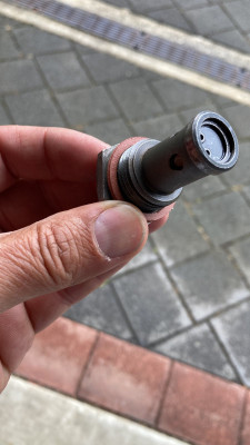

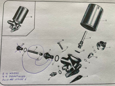

My S2 1600 engine was completly rebuilt and I recall when I first started, cold oil pressure was over halfway. When I took the car on its first test run last weekend, pressure was very low (just above minimum) and not really reacting to higher RPM. Have not done another cold start yet but thought I would check the pressure relief valve first. I assume it can be stuck in the open position so that pressure does not build? How do I know it is stuck open? I checked the parts book against my oil filter base and it seems to have more parts than I have on the car! I noticed item 14 is incated as discontinued - i made the corrections as shown on the page attached (Item 6 on my car seems to contain item 5,8,15?). Note part 9 is also missing the "stalk" - it only has the threaded part to screw on the filter. Hope someone can help me out here!

The series 1 relief valve consists of many parts.
The part you show is the series 2 relief valve. This one is known to very very occasionally not close. On the picture it is closed and looks properly cleaned. I doubt that valve caused the problem but it is not 100% ruled out. If you can find a series 1 valve I would replace the S2 valve.

Forgot toask - just to make sure - the series 2 oil filter housing does not have the insert with the pipe (number 9 in the pic in the post above) - just the threaded base, correct (as shown in the photo)

Yes. It is possible to lift the engine enough to replace the oil pump. You have to remove the hoses to radiator and some other stuff.
I can't remember seeing any Fulvia oil filter base without the nr 9 pipe.
