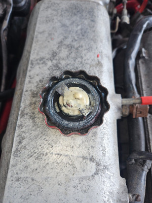

The car struggles to start, and when it finally does it billows white smoke out of the exhaust, and I have noticed a hint of blue too. I played around with the TPS and the starting is better but still not right. I have a 'creamy' substance around the oil cap but the oil look completely fine. I am leaning towards a headgasket change here, but just wanted to make sure its
not something else before I go through all that trouble. Ill be doing a compression test after work tonight to see what I get. I have LanciaTrek hooked up and it is saying all the sensors are 'OK' but im not sure how reliable that is?
What else can I check here before I take this head off?
