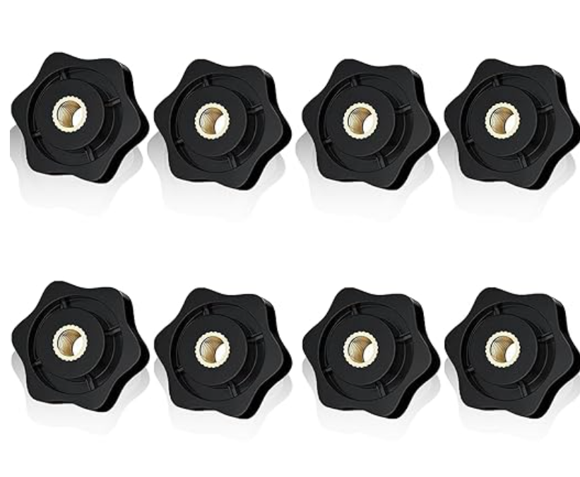

Hi, I've been replacing the dash cover (crash padding) on my '72 Fulvia. Because she was a Rally car in a previous ownership, there are numerous mods behind the dash, most significantly an electric cut out system required to meet Rally specifications. That makes undoing the dash cover nut above the instrument panel a real pain - replacing it even more so!
I figured I'd replace all the nuts holding the dash cover in place with star Shape Handle Nuts, this makes the job much easier when you are upside down under the dash. Tightening the nuts is now a piece of cake!
