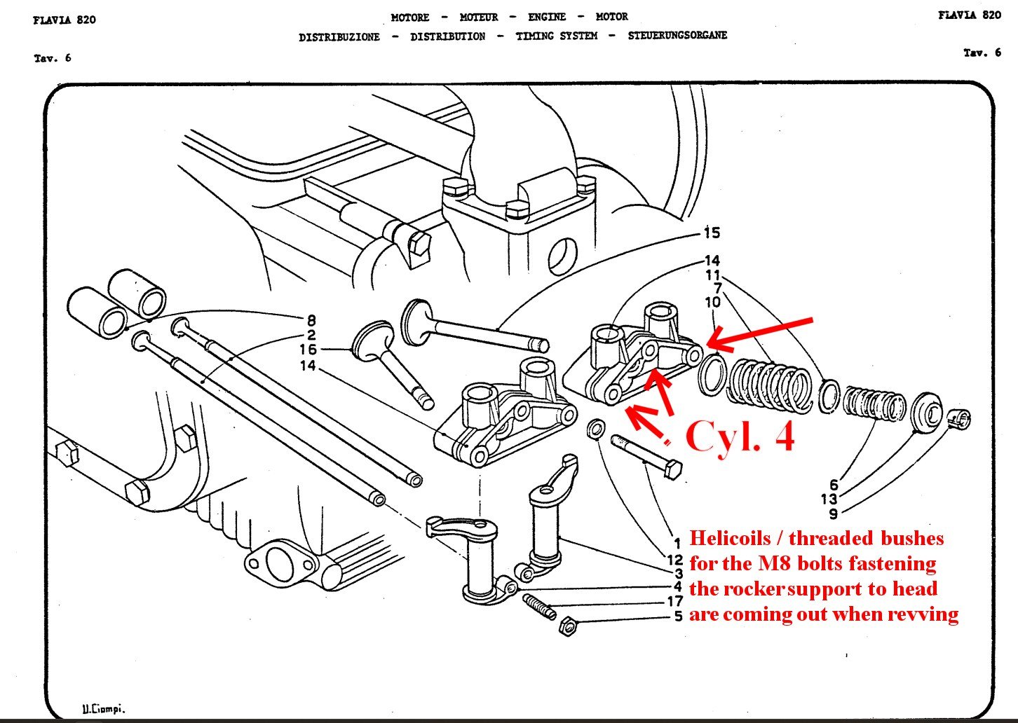

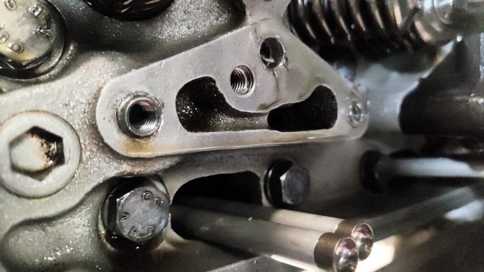

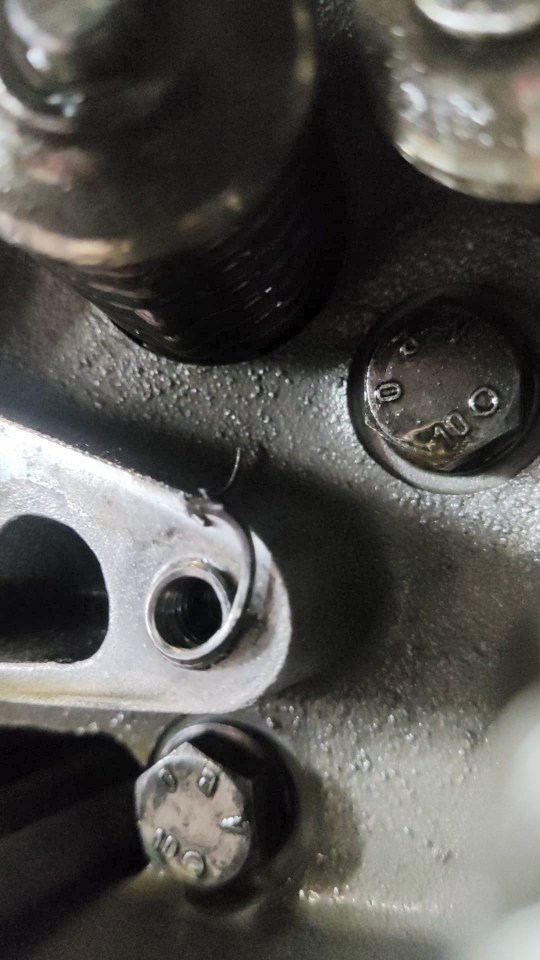

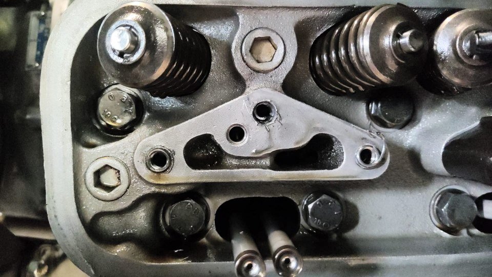

We just rebuilt a Flavia 2000 engine. Runs beautifully after starting. We can put an euro coin on its side on the air filter. But after some time the bolts for the rocker support of cylinder 4 come loose. And the helicoils / threaded bushes come out. Already when torquing the wrench does not click as sharply as on the bolts of the other 3 rocker supports.

I sent both heads to one of the machine shops I work with. The aluminium was tested and found to be in excellent condition. Most likely the thread was damaged before by over tightening or tightening against a loaded valve spring.
Inserts for the full length of the hole were made with special thread on the outside. All assembled with M8 10.9 bolts. They are now on the way back to me.
