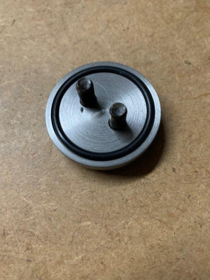

This O-Ring solution is only possible for 2.Serie 5speed gearbox. Depent on the different side shafts design.
S1 has a groove nut for fastening. Maybe something like this is also possible for S1. You have to take a look
whether this is possible or not.

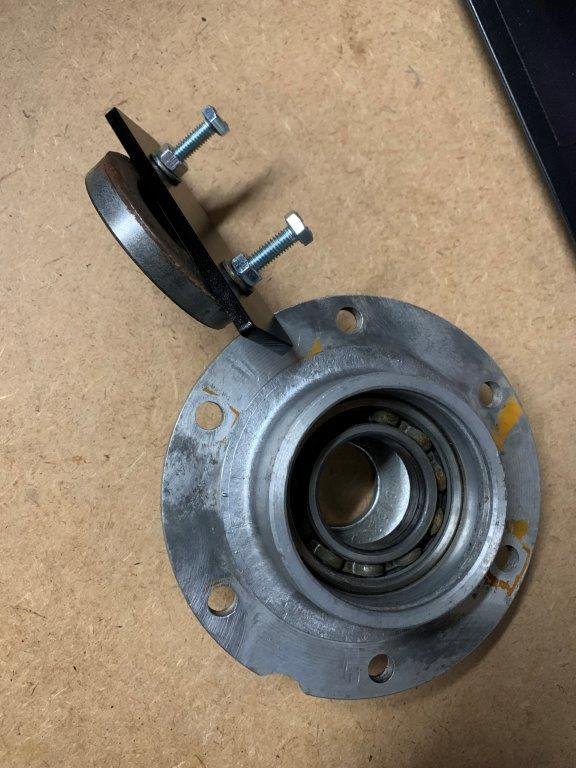

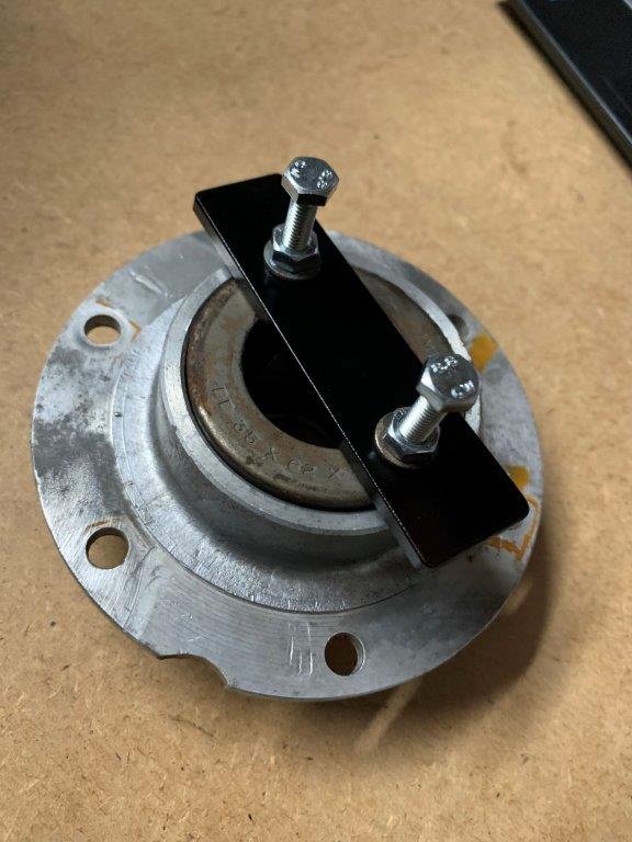

Any tips on removing the front seal in the belhousing? I have all but destroyed it by trying to use a sharp pic to pull it out, but I can't get it out.

I use what is called a bearing puller
