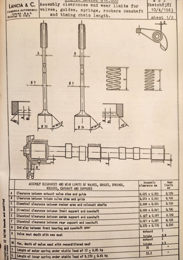

[attachment=0]20231109_203528.jpg[/attachment]
Sorry, the seals are at the engine builder so will check next time I am there.
The attached valve guide to stem tolerances are from the S1 workshop manual (A and B). I would appreciate if someone with an S2 manual can perhaps check for me what these values are for the S2 valves/ guides with seals?

I managed to find an S2 manual. Valve/ guide tolerances are the same as S1. I wonder why the valve stem seals were fitted on S2 and not on S1?
