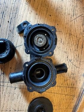

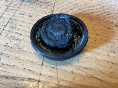

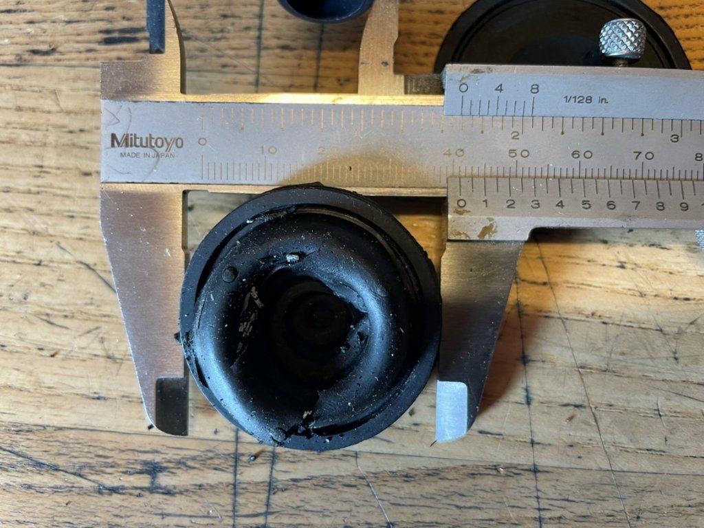

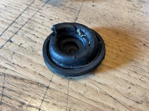

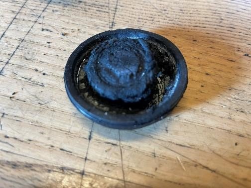

I have a problem with a leaking heating control valve. The membrane is broken and I cannot find a replacement anywhere.
I got 2 different, wrong membranes from Ricambio UK, I wrote to Omicron but didn´t get an answer. Anyone who knows where to get the rigth one?
Currently I have mounted a ball valve from the plumber, works fine but is quite uggly and very, very unlancia like......
